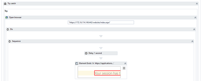

I was getting this error right after my open browser activity where I was using Element exist.
So I just added a 1 second delay inside open browser and before element exist. And now process seems to be running smoothly.
Now I am using 4 workflows in parallel activity and all set to isolated mode and it is working fine for me.
Not sure if this gonna work in every scenario but for my case after looking for multiple ways and raising tickets with Ui path support , when nothing worked, adding this delay seems to be a workaround for now.
Sounds like a stupid idea, but it work fine. :neutral_face:
Delay fix crash after opening the browser and after navigating to a new page.
