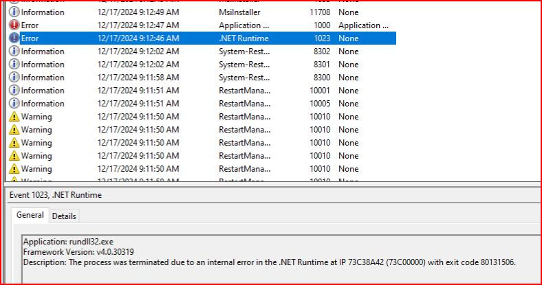

You didn’t try to follow my instructions.
You tried to run 24.10.1 installer, and you didn’t run the command that I provided.
Please take a look again and the above steps and provide the new log file.
Note:
  • You are getting a general 1603 error, but that is not providing any extra details except another general errors such as
SFXCA: RUNDLL32 returned error code: -1073741819
MSI (s) (48:78) [09:12:49:018]: Closing MSIHANDLE (22) of type 790542 for thread 16944
CustomAction DetectRelatedProducts returned actual error code 1603 (note this may not be 100% accurate if translation happened inside sandbox)
MSI (s) (48:30) [09:12:49:036]: Product: UiPath Studio -- Installation failed.
MSI (s) (48:30) [09:12:49:036]: Windows Installer installed the product. Product Name: UiPath Studio. Product Version: 24.10.1.0. Product Language: 1033. Manufacturer: UiPath. Installation success or error status: 1603.

I need this Version to work Marian, I replicated what you ran as close as it can with the environment I have. This is a test environment I cant connect to my Tenant in the cloud because this environment is isolated from our network so your connection string for the orcestrator and tenant will not work. I can get the new version but the rest is all it can be.
I also noticed this error recently if that is any help. potentially .net issue? I have also included the log file attempting with the newest veresion

Based on the logs, nothing changed, and you still have the same issues.
The rundllS2.exe process stopped because of an internal error within the .NET Runtime Framework. The error code 80131506 is generally associated with a critical failure that the runtime cannot recover from. It usually means there is a bug in the application (a bug cannot be possible as it was installed so far by numerous users), or the environment it is running in, that it cannot handle.
Here’s what you can do to troubleshoot:
  • Try to run the application with admin privileges, it might solve the problem if it’s related to the lack of permissions.
  • Try to install Download ASP.NET Core 8.0 Runtime (v8.0.11) - Windows x64 Installer and Download .NET Framework 4.8.1 | Free official downloads
  • Perform a Check system for updates → install the new updates → Restart the system → Retry the Studio installation
  • If you still get the same results after checking the generated log and after reviewing the Event Viewer → Application, System and Security logs → feel confident that you need to reach your internal security team for further help.
Thanks Marian I will give that a Try. I thought it was likely a security issue but to get the Security team to actually look into it I tend to need to exhaust every option for them to not just brush it off as user error.
I have tried updating the .net version with no difference. When my security team looks into it I will provide an update to resolve the forum post.
