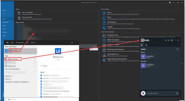

- Install UiPath Studio. This has the assistant build in. (there is no robot service you have to start). After installation, start Studio and the Assistant and you are ready to go.
- You can test your projects in studio itself.
- When you are ready, you can publish it. The package will be placed on your local drive and it will appear in the assistant, so you are able to run it from there.
When you build your first project and ran it in your assistant (or from Studio), you can move on to the next step.

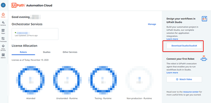

download a fresh copy of the studio from the cloud platform:
or this page:
https://platform.uipath.com/portal_/resourceCenter
install it as a normal user (you can check if you are a local admin on your system).
