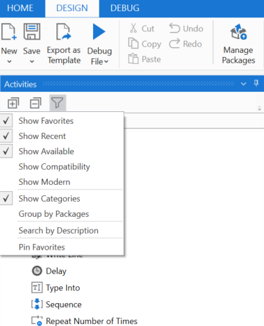

I used to be able to enable StudioX activities in the Activities panel by clicking on the funnel icon but for some reason it’s not their any longer! Do I need to install them somehow?

Hi @botdev75
If you’ve upgraded your studio to the newest release, 2021.10, then StudioX activities don’t exist how they did before. Try clicking on “Show Modern” and looking through that. The modern excel activities should be what you are looking for.
It would be better to set the project to modern rather than using show modern.
Sure.
I was simply explaining how to see the activities via the screenshot they uploaded.
