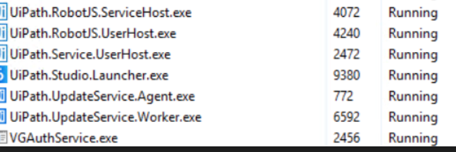

I am not a developer…but, working with my developer to make this work… from what I am showing you…does this look like I have a service bot or a user bot?
You have a service bot , Okay do you have a unattended license for that machine?

From the screenshot I sent you of the task manager… is that showing that we “only” have a service bot running…or is there a user bot as well…and how do I know what is running my processes
I think there should be UiPath.Service.Host.exe also should be running in the machine
I can’t see UiPath.Service.Host.exe running in the above SS you have shared
So it is better if you reinstall the studio with the steps in here

its magic! Thank you soooooo MUCH!!! We are now live and working with the VM closed!
