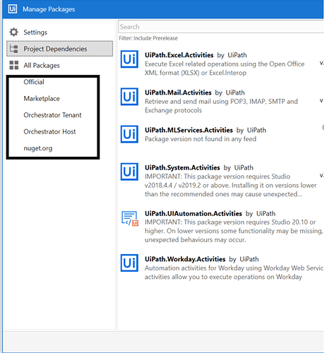

Hi @sandeep.tech2009 can you share what all feeds you’ve currently enabled in UiPath Studio. This would help us in narrowing down the problem.
Hi Naren,
Please find the attached screen shot:->
