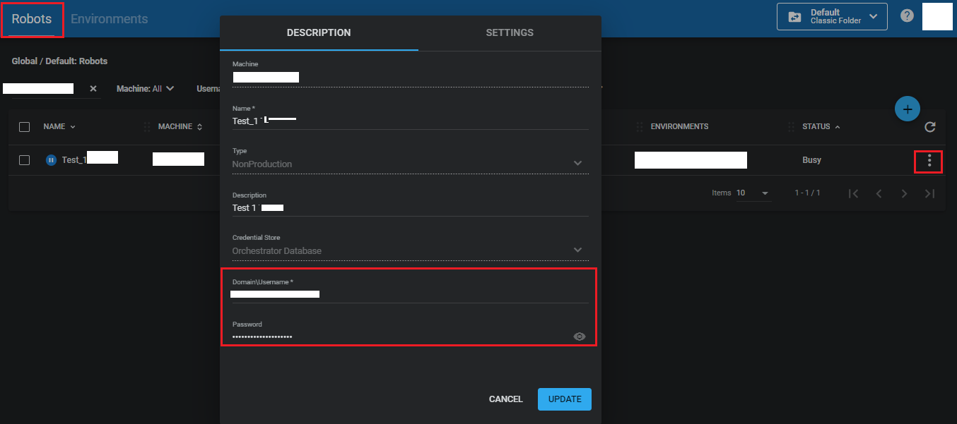

Set the appropriate login and password for the robotic station in the Orchestrator. "Robots’ tab.
Ui Robot can’t login to machine.
What’s the password, the robot is taking?? I’m unable to follow

Username is correct. But I do not know why, the robot is taking some password on its own. I am not even able to see it using show password. Even if i update the password as my system login password, again it is changing back to previous one.
Hi @shubham.bhattacharya
as of your last screen
When you select "Credential type " as a windows credential, you don’t need to enter the password actually, it will automatically update your windows login password. so don’t worry about it,
then any other issues do you facing now
