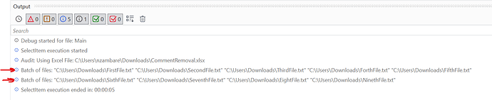

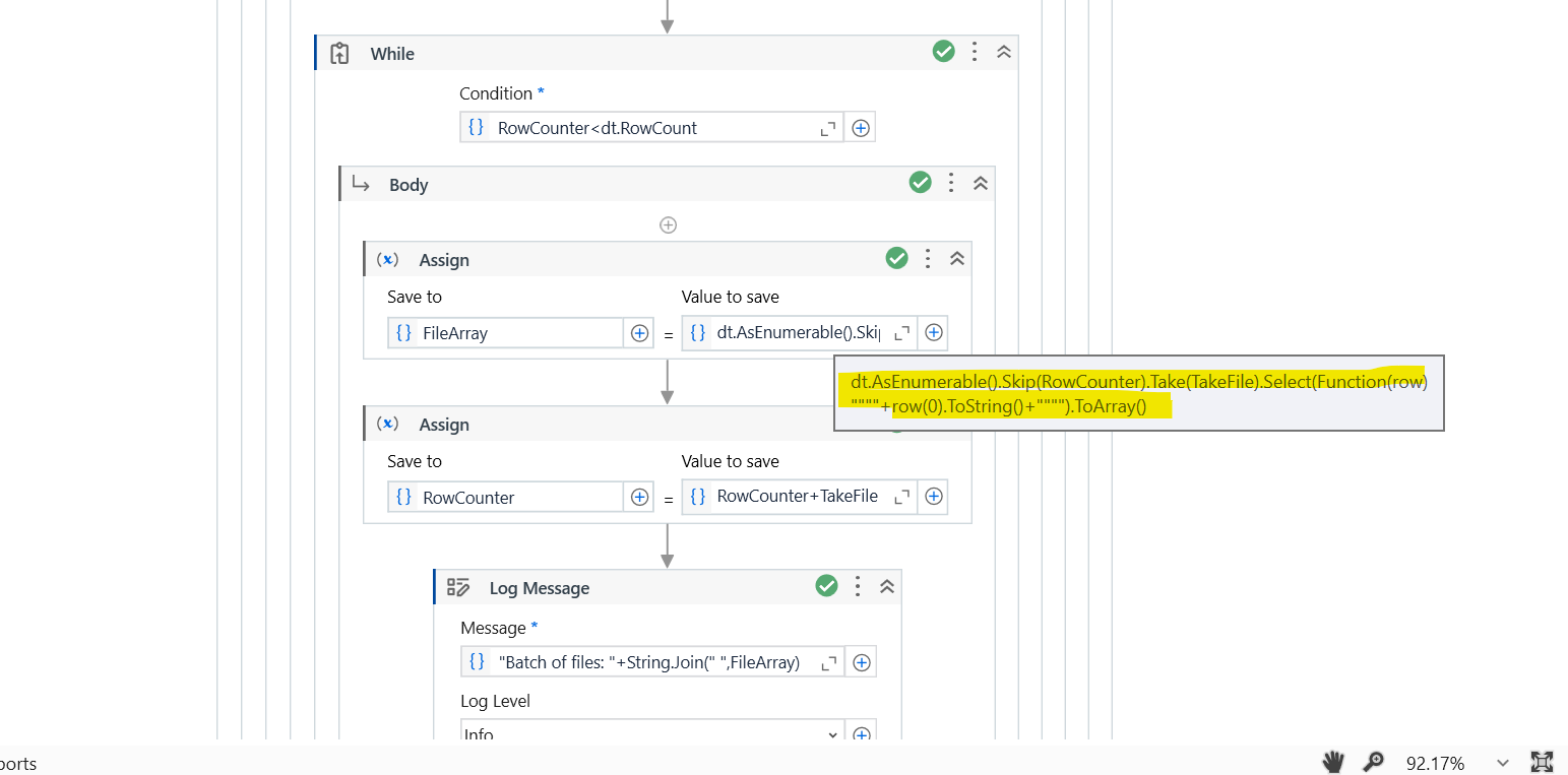

Dear @mihir.s.bandodkar,
Use below activities in sequest to get 5 rows from excel column at a time.
At the end(after log message activity) use type into activity to type string in file picker box.
dt.AsEnumerable().Skip(RowCounter).Take(TakeFile).Select(Function(row) """"+row(0).ToString()+"""").ToArray()
RowCounter & TakeFile varaibles are of interger type.
Input Data:
Ouput Data:
Hope this solves your query. :slight_smile:
