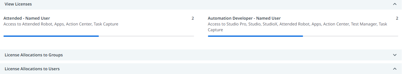

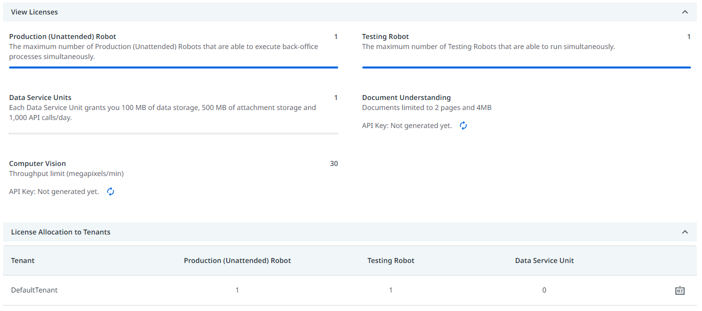

In admin setting, all licenses are given to my account.

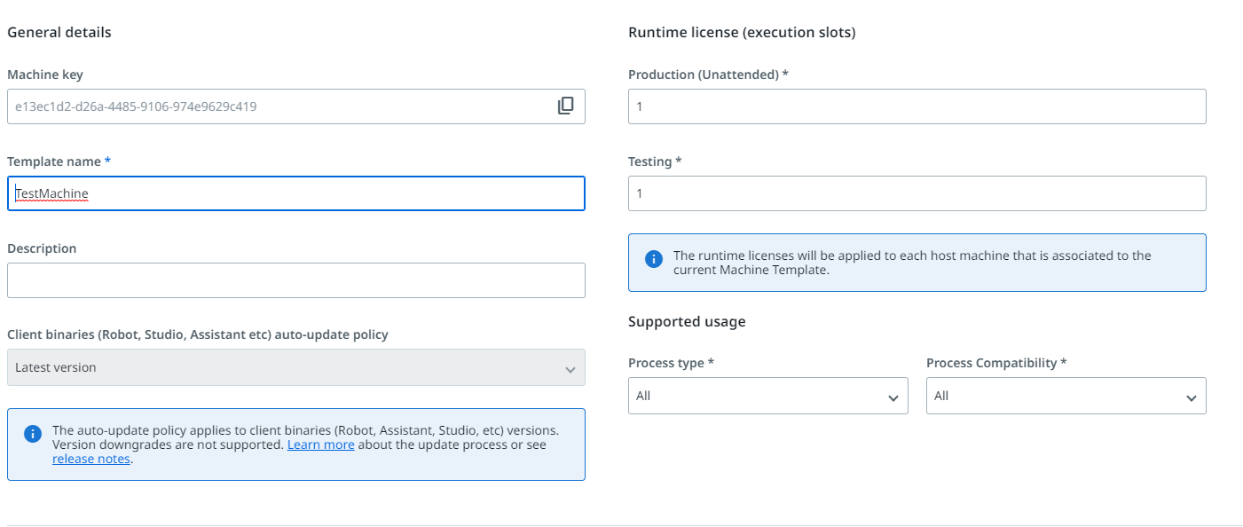

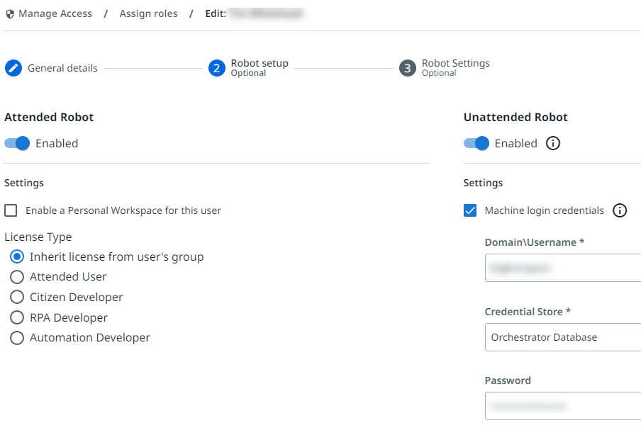

When you create the User or Robot in your Orchestrator Tenant, also make sure to enable the User with an Unattended Robot in Step 2 (Tenant > Manage Access).
If you are only interested in Background Automations, simply Enable Unattended Robot is enought. However if you are going to run Foreground Automations, you must also provide the credentials.

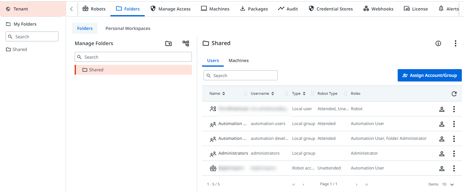

In addition to the above you must also ensure you have added the User/Group along with Machine to your Modern Folder (Tenant > Folders > Select You Folder).
