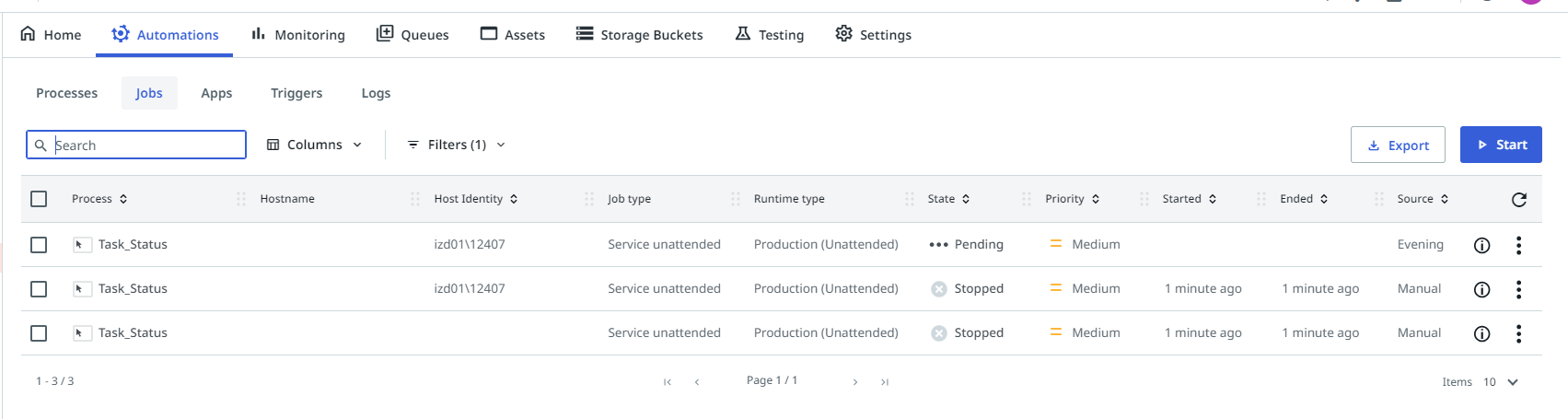

Hi @sathya_auto
Please check whether any pending jobs are there allocated to the robot. If any you need to first complete that else you can stop it.

Hello @sathya_auto
Is the robot available or connected to Orchestrator. check the robot status.
Hi @sathya_auto
Ensure that the robot assigned to execute the process is available and connected to UiPath Orchestrator. And check the schedule settings for the process in UiPath Orchestrator. If the process is set to run at a specific time or interval, ensure that the current time aligns with the scheduled execution.
@sathya_auto Please check whether the robot has been connected to the machine properly or not.
“Terminate” or “Delete” the pending job manually then this will allow new jobs to be triggered.

Hello @sathya_auto
Looks like the robot is an attended Bot, so we cannot trigger job from orchestrator.
Check whether you have license available for unattended and change the robot type.
We can trigger the project from the Orchestrator by using attended bot. While trigger the project in Process folder it will show in the Job folder in Orchestrator.

Thankyou got it…bot is attended
