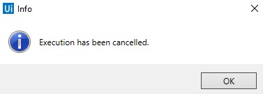

me too have the same issue, because of this not able to test the project. I think its an orchestrator/robot issue, appreciate if somebody can provide a quick solution.
even im faced the same problem for client hash use case i reinstalled and tried it worked fine
now for yearly report use case im facing the same problem even after reinstall it is not working its just popping up execution has been cancelled randomly sometimes after browser open some time after some page has been processed is there any solution for it
Yup
solution 1: robot tray if u look u will have your project either with update button or run button if u run it from there it will work but that too stopped in middle for me,
soultion 2 : uninstall your studio and install it again connect your robot to orchestrator and run it directly from the studio it worked for one my project , on the same it didn’t worked for my another one even im stuck @Dipanshu
@Vivek: I tried solution 2 yet…uninstall studio and install it again and connect robot to orchestrator and run it directly from the studio then it is working but when execute it from under Jobs section(Orchestrator) then it shows only Pending.
I have same issue. I reinstalled the Studio. However, I got the message again after connecting robot on the orchestrator. It looked fine after reinstall before connecting robot on orchestrator.
Are you talking about connection status on the orchestrator? I did not get pending. The robot connected correctly. However, I got same message whenever I run it on the studio.
