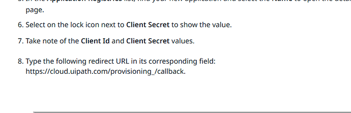

I am trying to using service now activities using Oauth2.0 . I have created an application registry but i am not sure what to use as the redirect url . This url works - http://127.0.0.1:10001/authorize/ but i am not sure if this should be used in prod . What do i use as the redirect url ?
You will have to use the same redirect url for PROD as well. You will have to set two applications, one for Dev and another for PROD.

Hi @DJha
For development, you can use http://127.0.0.1:10001/authorize/
, but for production, you need to use a public, secure HTTPS URL like https://your-domain.com/oauth/callback
and register it in your ServiceNow application registry.
Follow the below link for the setup:
