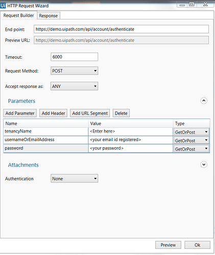

I` m trying to authenticate to the Orchestrator API ussing the HTTP Request activity, with https://demo.uipath.com/api/account/authenticate as End Point, following the instructions indicated in …
The returned status code 500 is always the service response.Any ideas on how to solve this issue? Is there any xaml example of this operation?

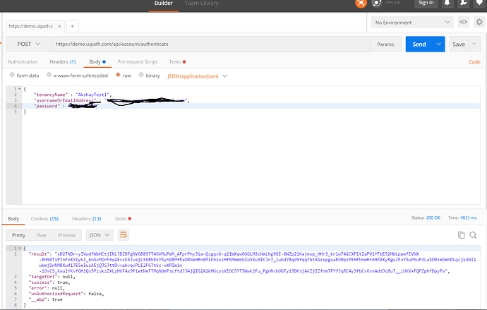

Hello Susana
You have to use Post Method with this api and to test it you can use postman api and pass the data with raw text option by replacing your demo.uipath.com credentials.
It is working for me:
and you have to use “http client” activity and it is working.
after that use “Json activities”: and use that as per your needs.
Regards…!!
Aksh
Hello @aksh1yadav,
With the postman app It is working for me too :slight_smile:
But with HTTP Request Activity I get the status code 500, maybe the problem is that I’m not filling the credential data in the correct way in the request builder tab. Could you help me?
Thanks!

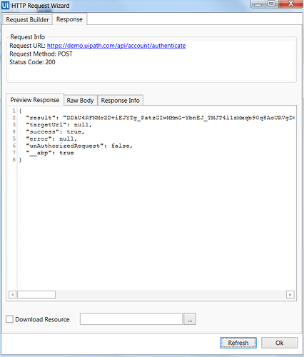

Hello,
Many Thanks @aksh1yadav :grinning:, I do not see any difference with my previous settings but now it works!!!
Regards
Please don’t forget about the Content-Type application/json header.
This could be the problem. The request looks good.
