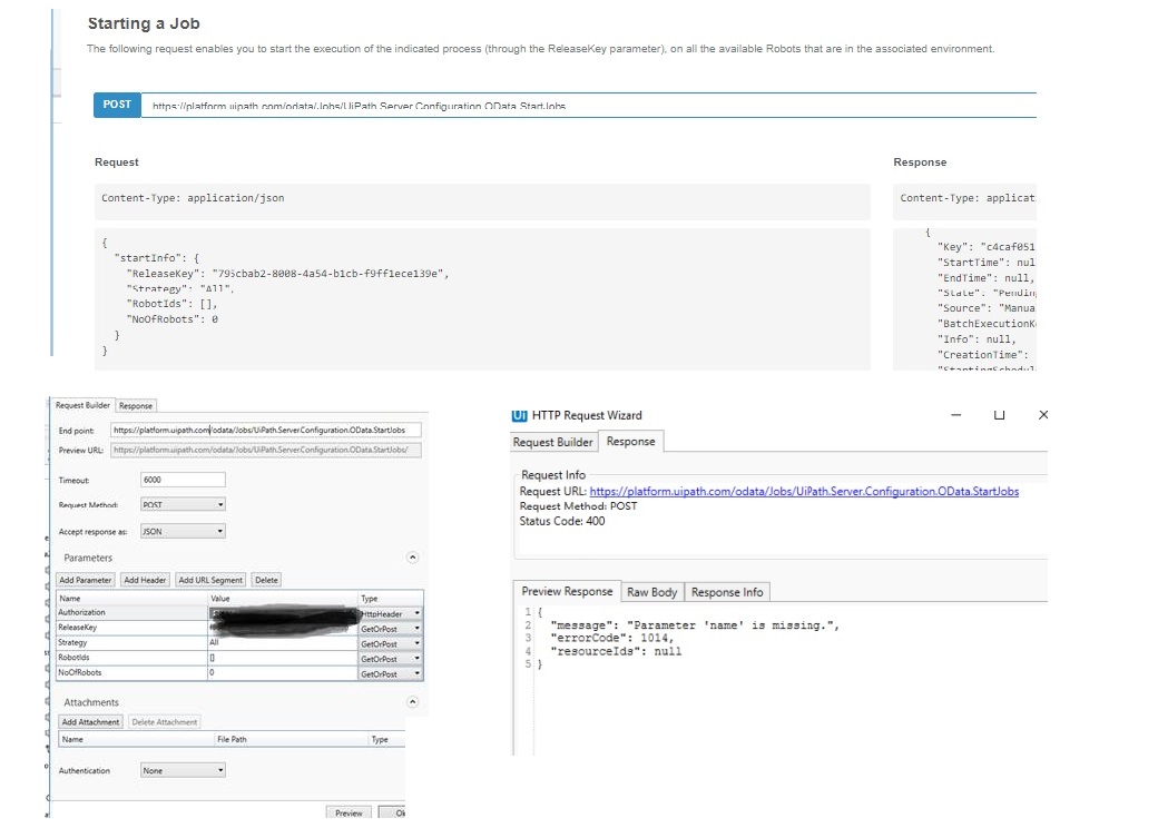

I writing to you in connection with a problem that I face when I’m trying to trigger a robot from Orchestrator via API. According to documentation on About OData and References starting a robot via API is possible after passing several arguments to the parameters like: ‘ReleaseKey’, ‘Strategy’, ‘RobotIds’, ‘NoOfRobots’ in the picture below. Additionally, I configured authorization as instructed on UiPath Orchestrator API : Authentication - #12 by aksh1yadav what helped me go through the first type of error - an error that says I’m not signed in. However, I encountered another type of error namely – ‘Parameter ‘name’ is missing’. I tried to search everywhere what type of parameter the ‘name’ is, however with no result. Only ‘name’ parameter that I found was the one that I saw when entering on https://platform.uipath.com/odata/Releases, however after copying it to the request builder parameters section – nothing happened. Please give me your feedback on this situation and potential hints what to do next to be able to trigger a robot via Orchestrator API.

I have got the solution with the help of a colleague (Many thanks to Joe Lasher!!).
As the documentation explains, all the input values should be inside a unique parameter “startInfo”:
“startInfo”: {
“ReleaseKey”: “xxx”,
“Strategy”: “All”,
“RobotIds”: ,
“NoOfRobots”: 0
I think the best way to avoid these problems is using Swagger UI for testing the REST API and don’t use the HTTP Request Wizard that could be confusing.
