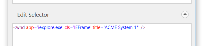

I’ve tried all kinds of stuff to fix the attach window and click logout button but no effect. The selector validator says it should work but nothing is happening

Navigate to WorkItems, SHA1 Get Hash Code and Extract Work Items attach browser incorrect(you need to indicate the body of the browser not the frame)

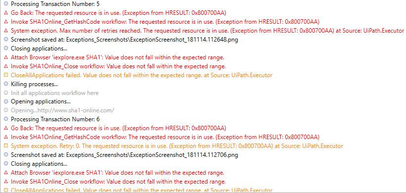

I encounter these errors when I run your workflow…
Hi, did you manage to reproduce the errors above?
I think in one of your flows you are using a Go Back activity.
Its SHA1Online_GetHashCode. Can you remove it? and then run again
I removed the Go Back activity… now it works but only sometimes and is inconsistent. Not all work items are updated with hash and marked as complete. It takes a few retries to handle most work items. I uploaded the project on the UiPath academy tester and didn’t do so well
