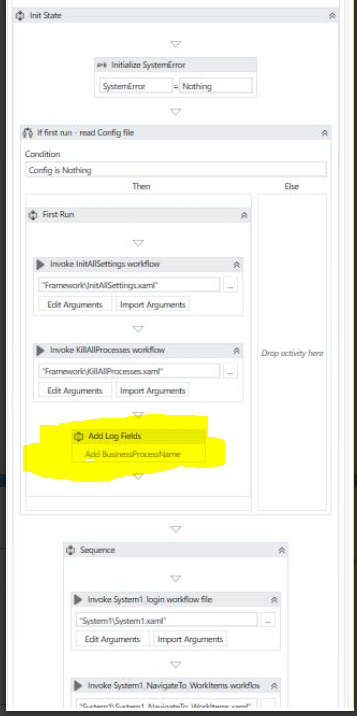

Can you share a print screen of the arguments in Init state where you have invoke of InitAllSettings.xaml ?
Also a screen of your config file.
Thanks @prankurjoshiand @nadim.warsi
I attached a print screen of init arguments state and of Config file.

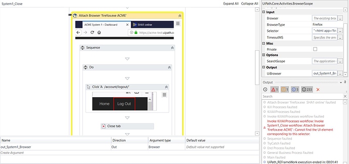

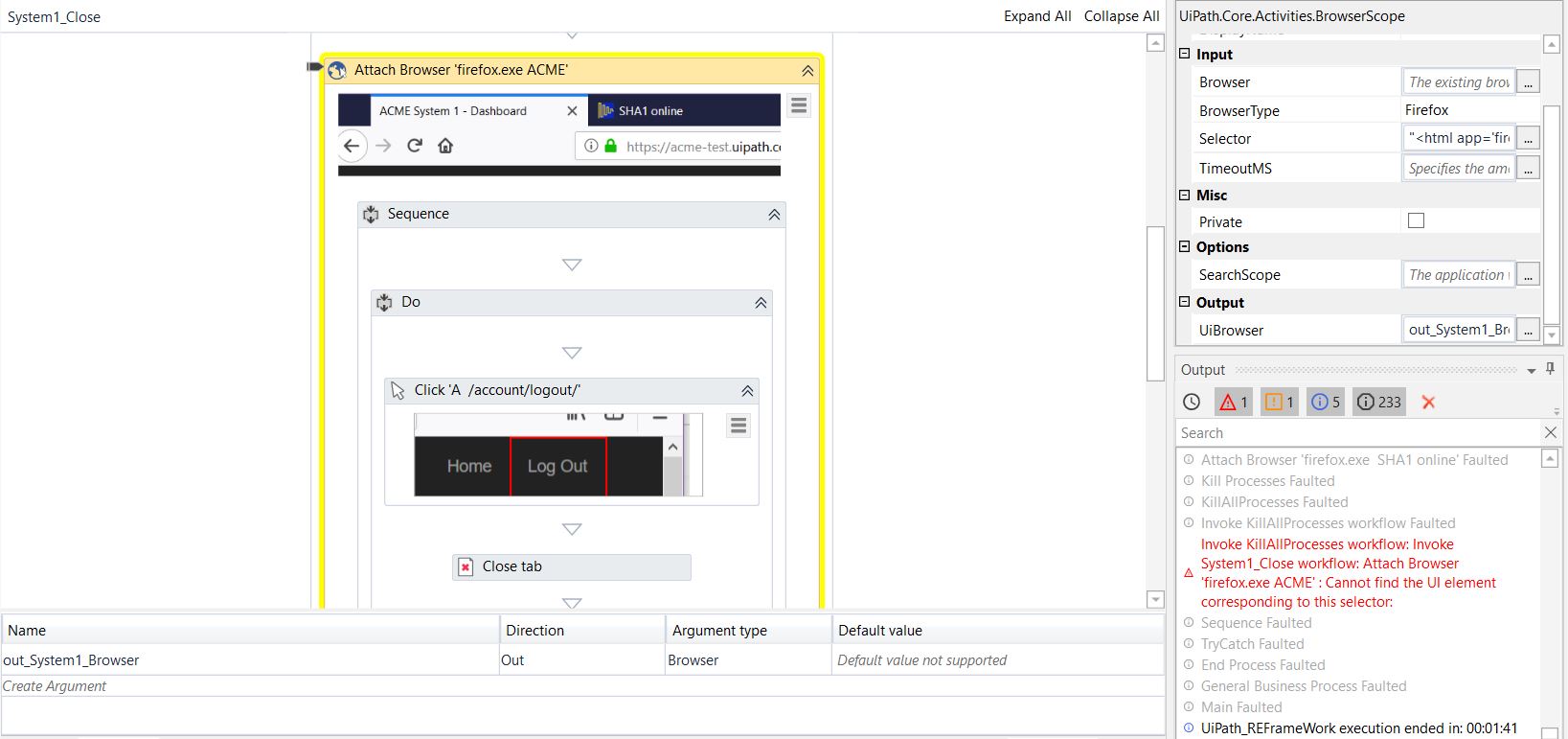

I found the problem in KillAllProcesses, it was just an incorrect argument but now the problem is in the System1_Close, as you can see here:
I don’t understand why I have these problems because it’s supposed to start with open browser…
Yes, you are right.
But KillAllProcess helps the bot start fresh. I can suggest to remove the logout invoke in the KillAllProcess and just keep ‘Kill Process’ activity.
Logout should be part of the CloseAllApplications and not KillAllProcess.
I hope you get the logic for the above.
Here that’s in “System1_Close” @nadim.warsi not in KillAllProcesses.
To be clearer, when i used the debug feature, I need to have my browser open with system1 and SHA1 Online pages open and login. So the program run correctly, logout and close pages but after I have an error message because the browser is closed and so he can’t found the browser with web pages open.
For me, it should to open the browser and then to login, run the process… and at the end to close and kill all applications.

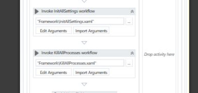

Actually what i wanted to explain to you is here.
Can you share what is inside your KillAllProcess?
sure, here you are:
I run Debug in slow step, and I see that in init statement it goes to “system error” that’s why he don’t start the process in the browser
why do you have the invoke in a attach browser? it will not be required. Just use invoke and KillProcess(iexplore.exe)
Once you remove that test once and without debug share your output panel logs

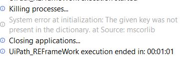

Now he run without errors but I have this message (below) and I don’t see the web page open, data extracting… and no data in my excel file.
Capture

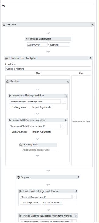

Ok, have you removed the logF_BusinessProcessName from your config file?
Yes, I removed it.
Add it back. Or in your init remove the log activity that uses it.
i will suggest add it back and give a meaningful name to the vale in the file
