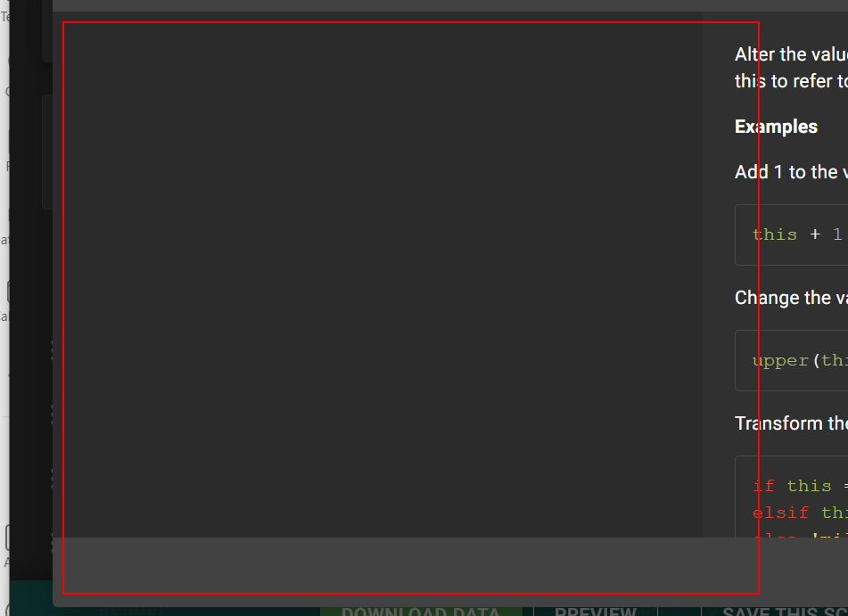

I am trying to type into a text box located in formula section of mockaroo.com site.
Due to some unknown reason, I am unable to type any text into that particular text box.
I have tried enabling ClickBeforeTyping and also a delay before typing of 5 seconds (5000).
Still no result. I have attached an image of that text box for reference.
Please Help.

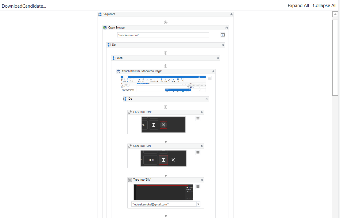

I am not sure how To share the steps so i am uploading my xaml project file.
DownloadCandidateMaster.xaml (22.7 KB)
Also I have attached images of workflow.

Hi @mukul_singh ,
it is resolved. the issue was due to you have not selected correct selectors for the text box. you need to spy the properties little carefully to avoid these mistakes and you have to capture the selectors by adjusting the spying screen. attaching the updated flow. please check. and also i have removed the simulate type into that is not needed. Normal type into itself it is working fine. thanks.DownloadCandidateMaster.xaml (22.6 KB)

While you are trying to capture any element(button or text field or text box etc.) you have to keep the capture screen clearly in the element area to get the correct selectors.

The text box you have selected sets the formula for ID instead of email.
When I select the text box for email, same problem again occurs because I am not able to find the right selector for that text box.
i am sharing the selectors below. whenever you are trying to capture the selectors for that text box please replace selectors with the below to resolve the issue.

Your most welcome. there is no trick. once you click indicate element it triggers the green box to find selectors for Ui elements there we have to keep the green box properly in the Ui element there it should fit accurately to get the proper selectors.
