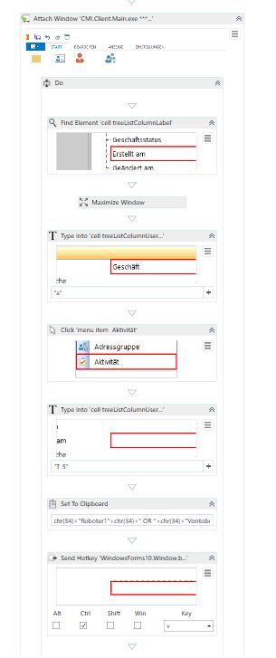

Thanks a lot for your help :slight_smile: The robot first opens the programs Notes and Axioma, then it searches for specific tasks in Axioma that it will later convert into meetings in Notes. The problems occur when the robot fills out the form to search for tasks. The dropdown (nr. 1) is also tricky as I have to use the down arrows and " " to confirm the points. For the type into I now use the method aisling.bai described (with copy to clipboard and then paste). This is a bit more reliable. I think it is like the program sometimes loads GUI elements at a different speed or something else that causes the robot to lose focus. I can share a few pictures:
Hi @Jizh,
Then kindly use on element appear, before typing to the field or use DelayBetweenKeys in type into activity that will add delay while typing each character in the string
