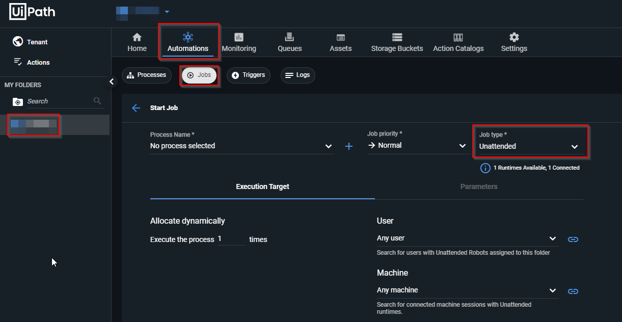

You could try to start the job manually on Orchestrator to find it:
1- Navigate to the folder where your process is created in Orchestrator
2- Go To Automations - Jobs
3- Start manually a process (clicking on the “play” button on the right)
4- Check the value on the “Job Type” field after selecting all your process details:

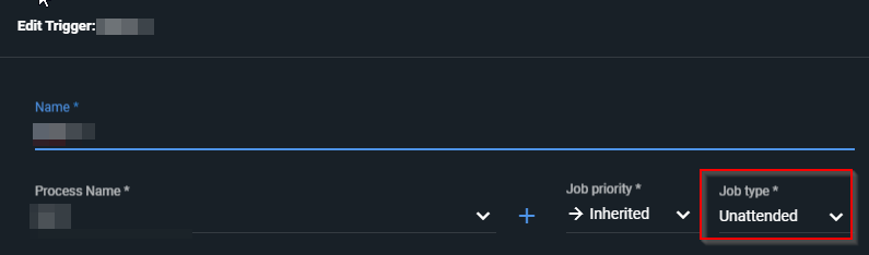

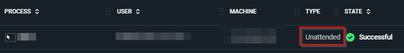

From the triggers page, it can also be found:
*Depending on the version of Orchestrator you’re using, the screenshots might change a bit
