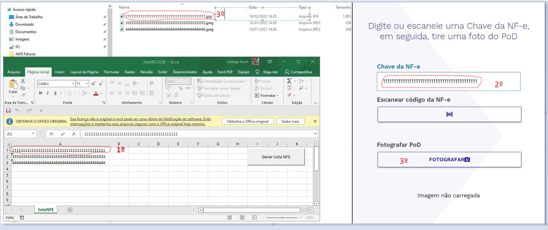

Guys, what strategy do you indicate, I need to create a robot that will get file names from an excel list, give input in a form, then attach this .jpg file that he gave input in the form?

Basically I need to do these 3 steps:
1st generate the list with the name of the files
2nd input the filenames
3rd attach the corresponding file
And finally move all files to another directory.
