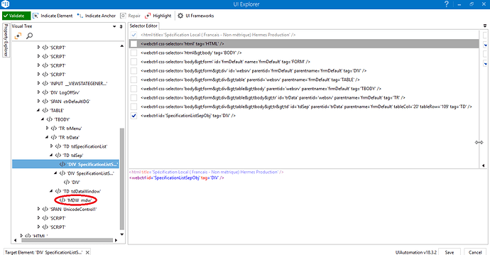

I am facing a strange issue. Some elements of a webpage cannot be identified with selectors. In some part of the page, no selection area appears and the selection stay located on the previous area selected… (see screenshot below, I am trying to identify elements on the right part with the mouse)

In the highlighted window you can see the type is “mdw” which is a multi document window, and does appear to contain a frame (perhaps?) as you can see class=“mdwIFRAMECell” which makes me think it’s a frame within one of the windows. It could be that UiPath is simply not able to read into this section of the website as it can’t cope with mdw?
I have experienced today where it is unable to “see” the Windows Calendar from your task bar so this could be a similar issue.
You have tried also using “Select Image” and get the same issue I think you said, which makes me think UiPath might need an update for this? I could be wrong though, I will try and summon the mighty @loginerror or @nadim.warsi for their wisdom?

Please find below a screenshot highlighting the most detail element I can pick: it is the separation bar between the left part where selectors work and the right part (light blue) where I want to pick data and where selectors do not work.
A second screenshot with the UiExplorer interface. For information, I think that the light blue area corresponds to the “MDW” html tag.

It indeed looks like there might be lack of support for this particular structure of your website.
Our team is investigating it further.
Would it be possible for you to provide at least a snapshot of the website (.mht file)? It would help a lot :slight_smile:
