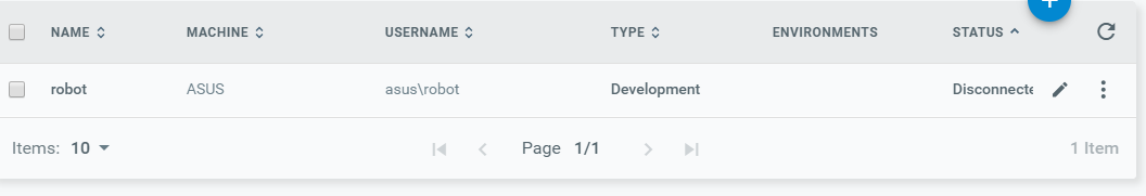

Hi all, i’m facing the same issue and tried the command line. My domain name is asus.
Not sure why the error message says “Robot does not exist”
what is your username?
do a whoami in cmd and use that as the username for your robot and pass the windows login password also

Thanks for the reminder. Was using the correct domain name but wrong username. :slight_smile:

I did like what you said. But still robot is unavailable.
Machine: Machine Template, Robot: Development Floating Robot.
Can anyone help me to fix this issue?
Can you hover on the status and let me know what the message you get?
Robot does not exist.
You have not created any robot?
Create one under robots tab and use this machine.
I done everything. But i don’t know why its not working. Standard machine is working but floating machine is not working, that’s why i can’t understand. If i try to do in attended means showing error to update the license.
I have done the steps for floating as well and it works perfectly fine.
I think your username is incorrect. have you tried whoami in your system commandprompt?
And you password should be the same as the one you use to login to your system. verify once and confirm.
You do not need to select attended.
I tried that, the username is copied from the whoami command and password which is my system login password i have given.
