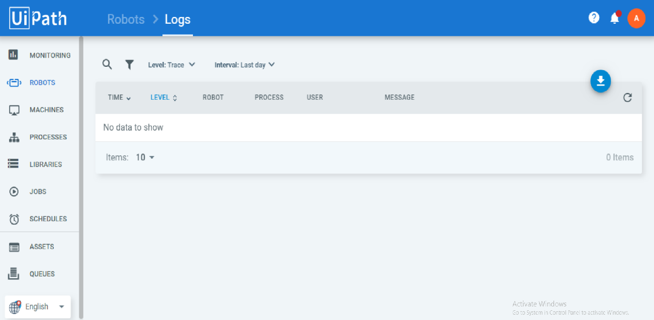

I found that if you are conected to orchestrator you can see all the info or error log that your execution generates at Log Page in Orchestrator, but when I triggered a Job since Orchestrator, I enter to Log Page in Robots and I see nothing:
Important: Orchestrator status: conected, Robot logging level:info, version:2019.10.2

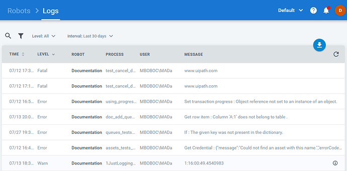

but these is not that I want, i want to see them in Orchestrator like this:

Try changing the Interval Filter at the top to “Any.” The 2019.10.2 update defaults all the log intervals to “Last day” rather than the period when it was run. It’s annoying if you’re looking at logs from prior days.
