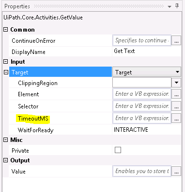

Can you try the get text activity, and extend the timeout parameter?

get text activity does not have timeout property. Please clarify your suggestion
Hey @Purvi,
Try using get text activity and select only the text inside that pop up box.
After that you can use if something like :
if (getTextMessage.Contains(“Error”)) then some action.
If you’re having trouble finding the element, check the selector through UiExplorer
