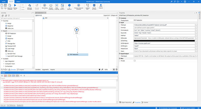

What did I wrong?
Please help me…
Error message:
RemoteException wrapping System.ArgumentException: No compiled code to run
error BC30451: 'regex’이(가) 선언되지 않았습니다. 해당 보호 수준으로 인해 액세스할 수 없습니다. At line 49
at UiPath.Activities.System.Utilities.InvokeCode.CompilerRunner.Compile(String code, Int32 errLineOffset, Boolean generateInMemory)
at UiPath.Activities.System.Utilities.InvokeCode.CompilerRunner…ctor(String code, String className, String methodName, Int32 errLineOffset, Boolean generateInMemory)
at UiPath.Activities.System.Utilities.InvokeCode.VBCodeInvoker.GetCompilerRunner(String code, String className, String methodName, Int32 errLineOffset, Boolean inMemory)
at UiPath.Activities.System.Utilities.InvokeCode.NetCodeInvoker.GetCompilerRunner(String userCode, List1 args, String imps, Boolean inMemory) at UiPath.Activities.System.Utilities.InvokeCode.NetCodeInvoker.Run(String userCode, List1 inArgs, IEnumerable`1 imps, Object args)
at UiPath.Core.Activities.InvokeCode.Execute(CodeActivityContext context)
at System.Activities.CodeActivity.InternalExecute(ActivityInstance instance, ActivityExecutor executor, BookmarkManager bookmarkManager)
at System.Activities.ActivityInstance.Execute(ActivityExecutor executor, BookmarkManager bookmarkManager)
at System.Activities.Runtime.ActivityExecutor.ExecuteActivityWorkItem.ExecuteBody(ActivityExecutor executor, BookmarkManager bookmarkManager, Location resultLocation)
Hi @Bokyeong_Ko - I’m wondering if there are any dependencies missing?
Would you mind also trying these two things:
  • Can you provide a screenshot of your projects tab
  • Set the OCREngine to “uipath” lowercase
  • Enter a variable into FileOut parameter… Define it something like “C:\Output\redacted.pdf”
Thank you for reaching out.
Here is the screenshot of your projects tab.
The same error occured… :cry:
oops mistake , Here is the screenshot of “my” projects tab.
Hi Bokyeong,
Would you mind upgrading your UiPath.System.Activities to 20.4.0 or greater ?
still getting the same error message…
Is it because I’m a community edition user? Do I have to be a Pro user to use this activity?
