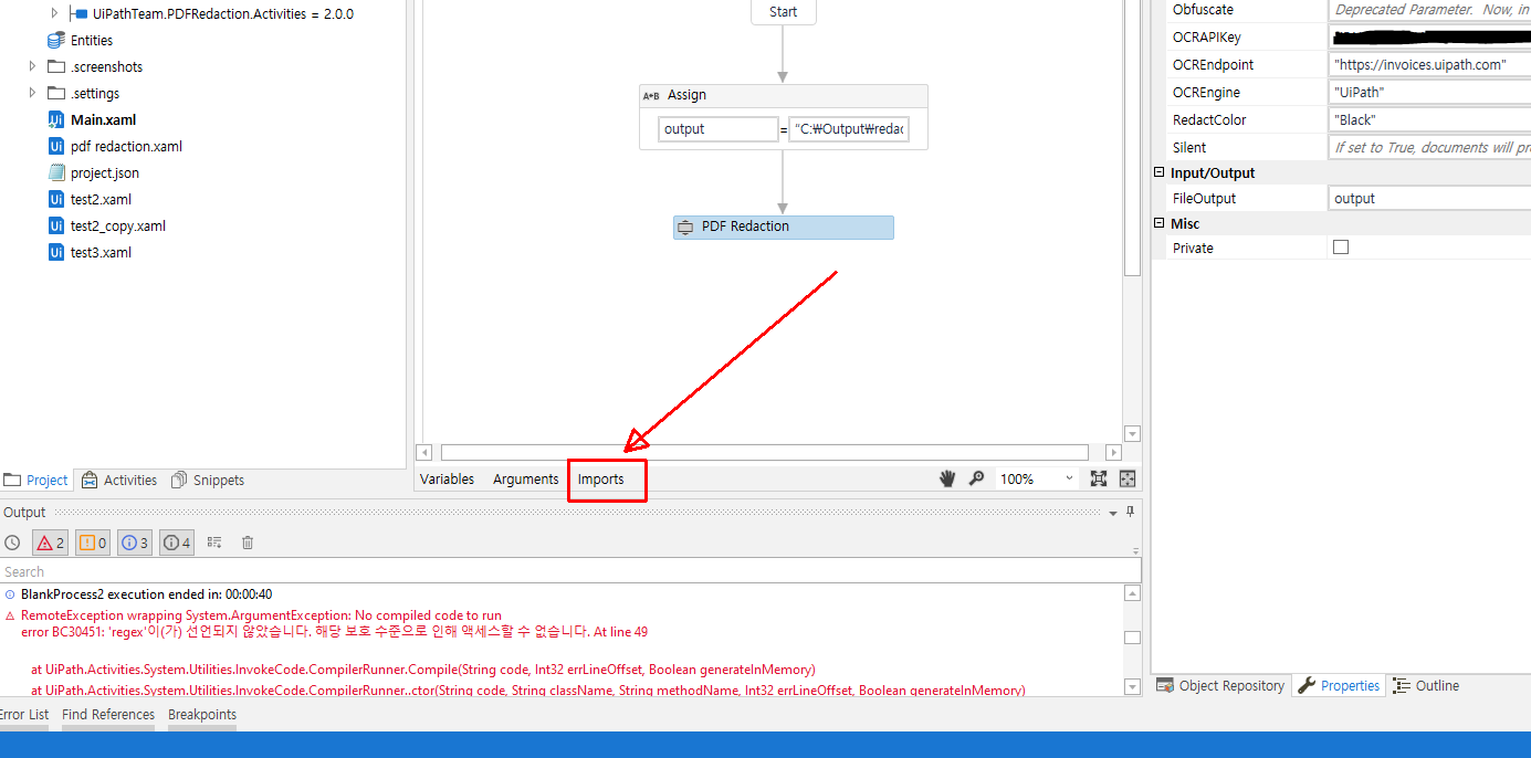

No, using community version is fine… the error is happening with regex… Would you mind adding the Dependency into the Import tab.
Click: into the Import Tab.
Type: System.Text.RegularExpressions and click Enter.

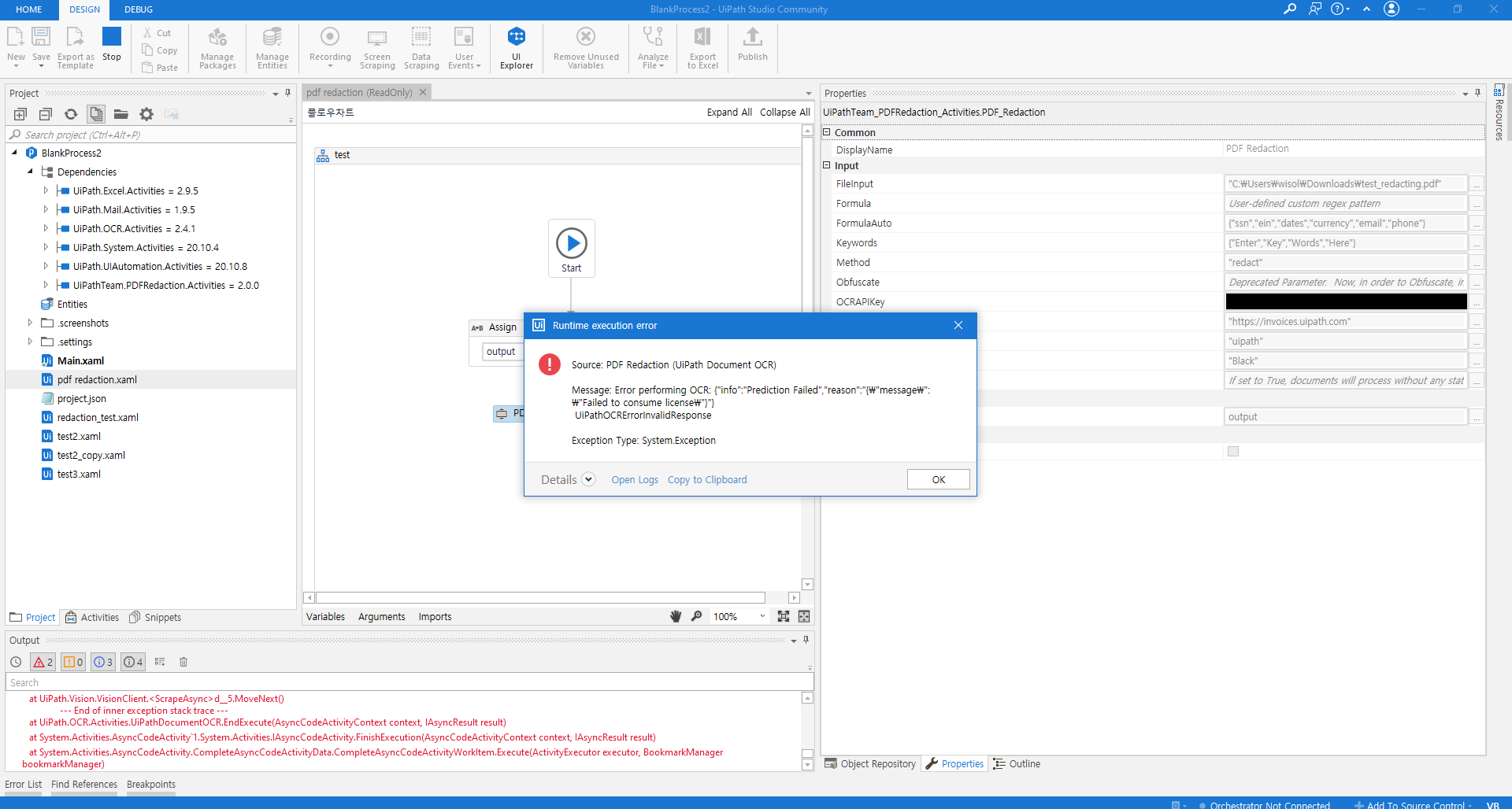

It did work 2~3 times after I imported ‘System.Text.RegularExpressions’ , But I’m getting this error message now.

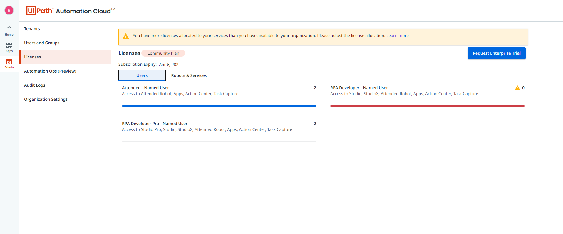

maybe there is a problem with license allocation…
Hi Bokyeong,
It depends, are you running StudioPro on your machine? If you’re running Studio, then you’ll need to allocate a license for Studio… Are you able to run any other automations without a problem? I believe you are not. Alternatively, what you can do is change your Studio profile to StudioPro

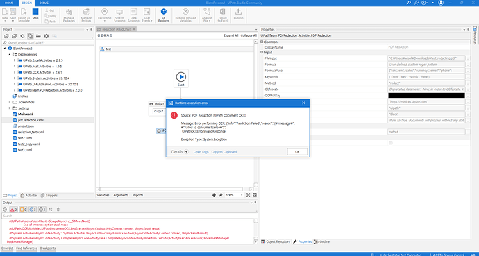

I’m using StudioPro now but I’m still getting the same error message…
Please set the OCREngine argument to OmniPage, which is the default engine. This will most certainly work.
the License error is probably because you’ve entered the wrong API key for “UiPath OCR Engine”.
Thank you~ I’ve changed it to OmniPage.
