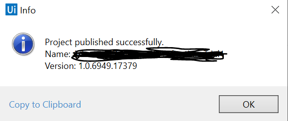

I am currently doing Lesson Orchestrator 2018.3 - Video part 1. I have followed everything in the video but I am unable to assign my published robot into an environment.
it says here that I have successfully published my project.

Seems like there is some misconception in this (do correct me if I’m wrong). The robot is not published. The package is published. For the package to appear on the Orchestrator, the robot must be connected to the Orchestrator first.
Currently, you’re publishing the package locally, in the local file location. If it is connected, it should have the following message when published, without the file location:
