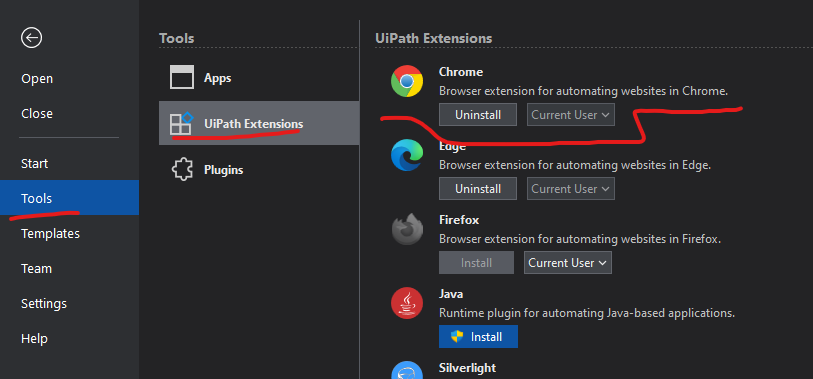

Hi @rameezimtiaz
can you try re installing the extension from studio?
