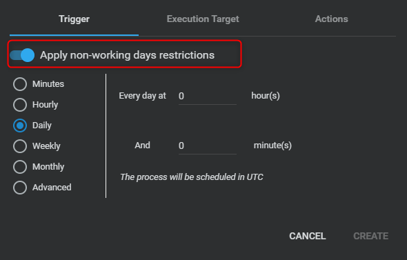

You have an option to restrict on Non-working days -
Thanks @KarthikByggari but unfortunately I am not able to enable this option. What could be the problem?
