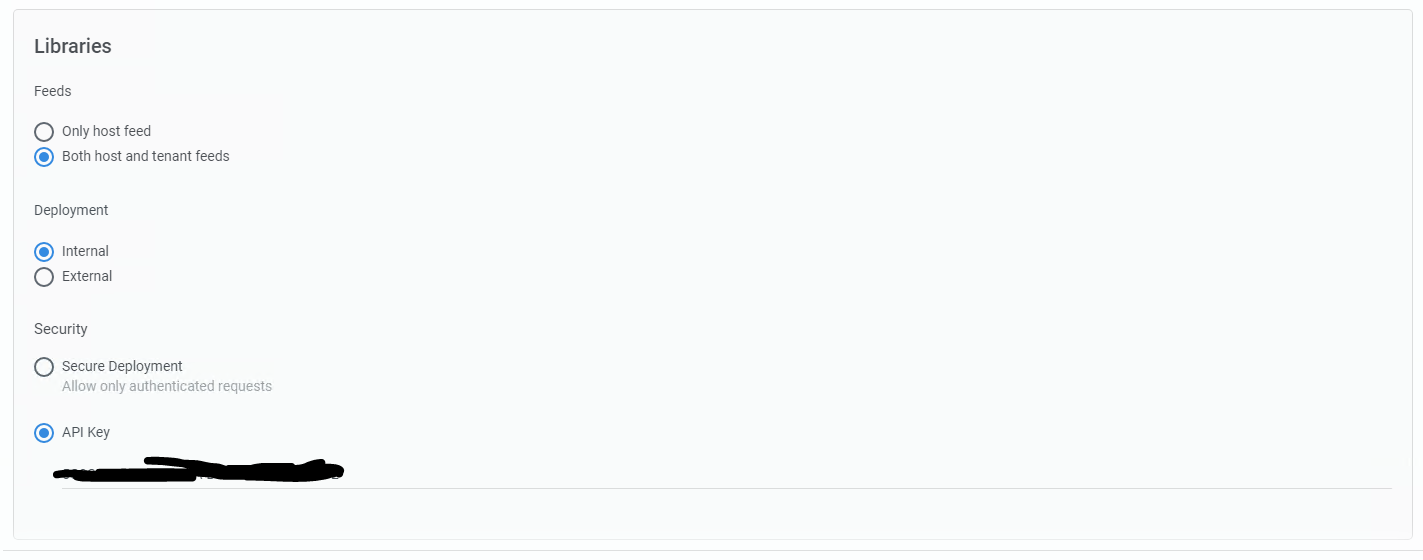

I created a blank new Library however I’m getting this error when I try publishing to my Orchestrator. I have only created one activity with the appropriate arguments. The installed package I’ve added is the latest Alteryx Activities Package. 1.0.4
Error:
Here are my orchestrator settings:
See Log messages:
16:10:45.0212 => [ERROR] [UiPath.Studio.App.Logging.OutputLogger] [58] The assembly compilation returned the following errors:
‘ScopeActivityBase.TelemetryEnabled’ is obsolete
The variable ‘v34’ is assigned but its value is never used
The variable ‘v35’ is assigned but its value is never used
The variable ‘v40’ is assigned but its value is never used
The variable ‘v42’ is assigned but its value is never used
Failed to emit module ‘Alteryx’.
16:10:45.0222 => [ERROR] [UiPath.Studio.exe] [58] The assembly compilation returned the following errors:

Using 2020.10.2 Studio. Enterprise license. Tried with Non-Prod and Studio.
I tried to drop in the xaml file directly into the main existing Library folder path where the rest of the existing library xamls were under. This new xaml uses the latest Alteryx 1.4 Package.
I think it has to do with one of the Alteryx activities. I was able to publish a blank library with the alteryx dependency but when I added the Alteryx Scope Activity and Run Job Activity within it, it would fail to publish with the same above error message.
Goal is to create this component with ease of using Assets/Credentials as arguments to run specific Alteryx jobs of specific workflows. The Secret/Key in Alteryx would be maintained as a credential via CyberArk, while the actual Alteryx Server Base URL is already configured within the component’s Alteryx Scope Activity (never changes). @paul.hoeffer you might be needed again
