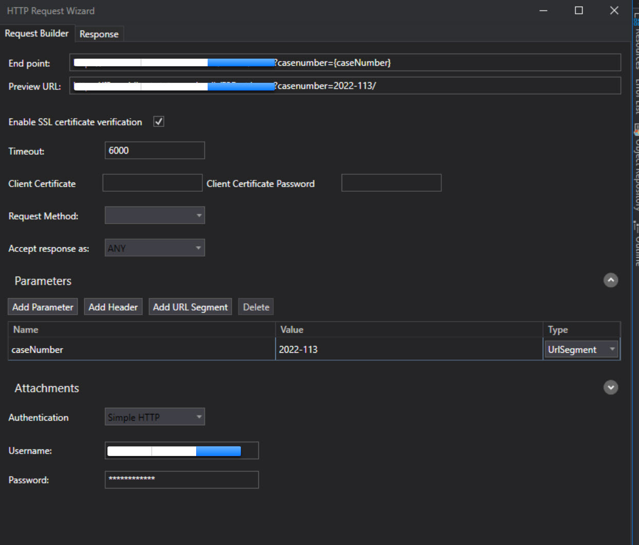

Http request with URL segment, working in postman, but not in uipath
I am using http request and I need to do a request with a custom url segment.
I’ve been looking around for the solution, but whatever I tried, it didn’t work until now.
The URL works in postman, but it doens’t work in uipath.
I’ve been experimenting with parameters, adding url segment, assembling the url before the http request… all unsuccesful…
URL working in postman:
URL in uipath:
Thank you all in advance!

I tried all those. The only thing I need to add are the headers from postman. But in postman I only specified endpoint, method (get), authorisation and the URL segment (variableToSearch).
I’ll try to add the headers
You mean to check if the value resulted in my Write Line (final URL) will also work in postman?
It does. I checked that out.
So I mean that I checked the exact link that I underlined bellow. I copy paste that in postman and it works in postman.
