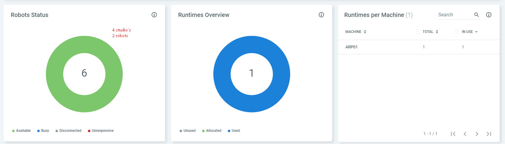

Im currently facing a small problem within the orcehstrator. I want to use a second unnattended robot while I have one unnattended license (one runtime that will be executing back office processes simultaneously). I can connect this second robot no problem but when I want to excecute a process with Robot 2 I get an error: “Robot Licensing Failed. There are no available runtime licenses. (#1915).”
What seems to be the problem is, is that Robot 1 never releases the runtime license (Even though it is not processing any processes at the moment).
Do you have any idea to resolve this problem?

hi @Peter_Peter
on your issue is simple
you can create multiple robot and keep standby but as mention your license dashboard you have only one runtime license so , you cannot run/connect your second robot while running or connect the of your 1st robot in to orchestrator
you have 100% utilize your robot license count
