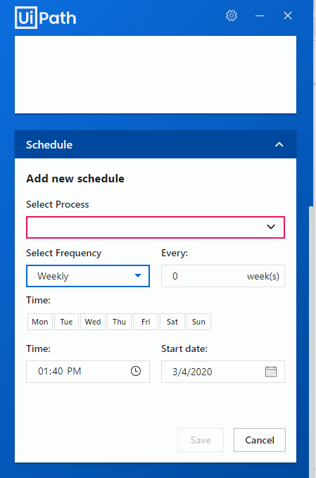

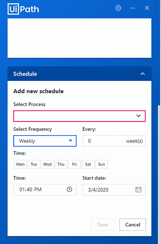

if so cant you can use task windows task scheduler (but remember now is’t not recommended )
and following link having the already created component for it
