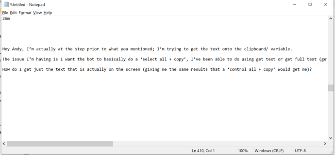

I was working on something similar. Therefore, I’ve attached the XAML. The result is shown in the screen shot below.
Here is a rough draft of how this works.
- Open this forum page in IE Browser
- Open an empty Notepad document - for this test, it must be the only notepad window on the desktop
- Run the XAML.
- It should select all the text on this page and paste it into the Notepad.
It won’t work the second time because the title of the Notepad window changes from
Untitled to *Untitled
once text is pasted into it, indicating that the Notepad document is unsaved.
Therefore, close Notepad and open a new window each time before you test.
