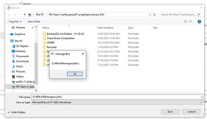

@caduque Yes , I think it is Still Not Solved, Need more ScreenShots of How you are Saving the File, using Type into, After Type Into Activity Put A mEssage Box to Halt the Process Just to check what is the Value that is Typed as the Full Path.
Here’s another sample. Please note that the filename is not included.
@caduque That’s Not the Way a File Path is Stored right, You can clearly See that the Path is the error,
It should be Something like this :
G:\RPA\HREmployeeRos\yourFileName

And yet it didn’t work again.

Oops. It didn’t work. It still saved from the previously opened folder.
