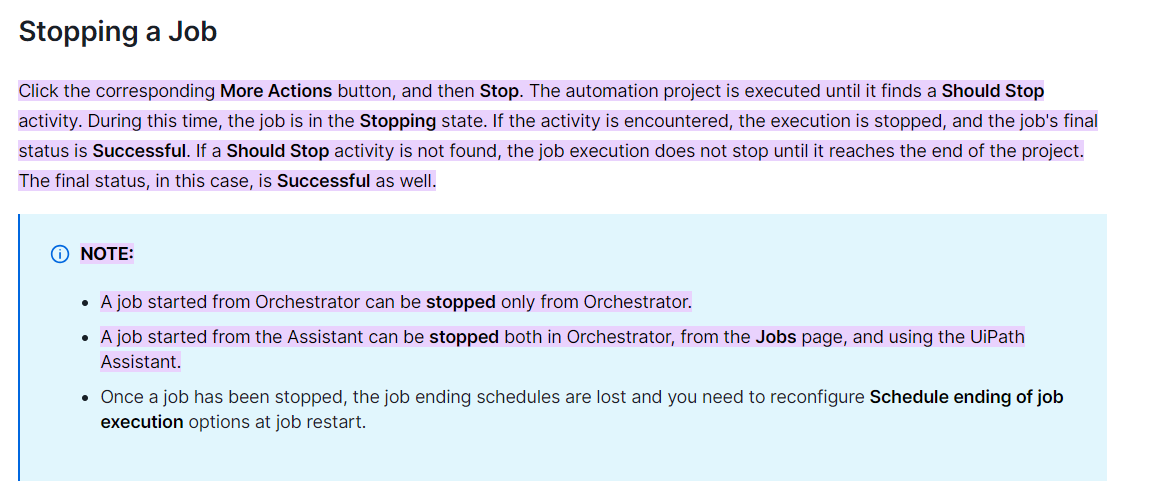

Hi @Hendaryie_Tjoeng
Please check on this
