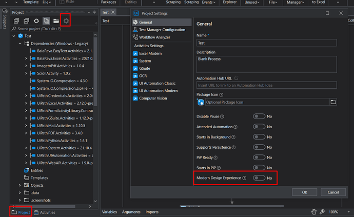

Can you confirm that Modern Design Experience → Disable

Hi @Komal_Surjuse
Have a look on this thread for GetApp Credential
Regards
Gokul
