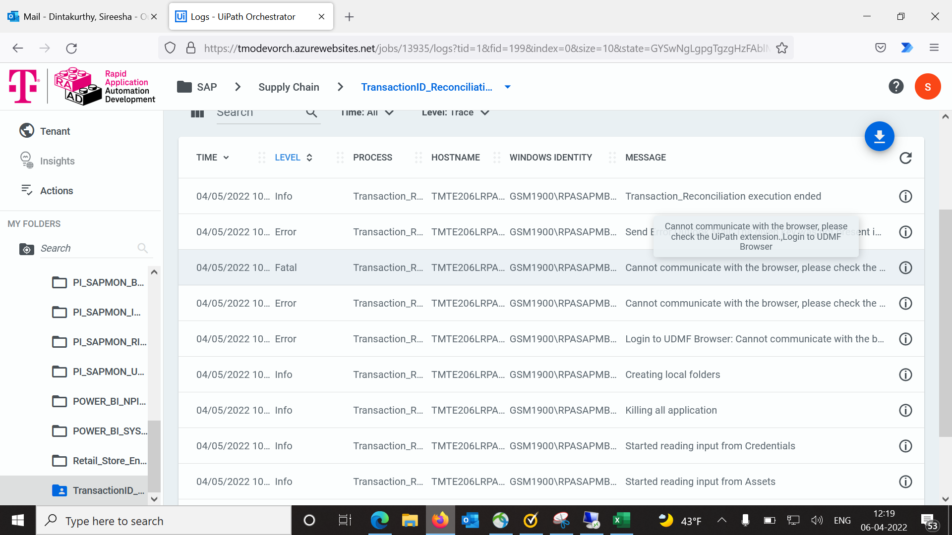

Hi Team,
I am getting the error mentioned in screenshot when i am running the job from orchestrator. but while i am running it from studio, i am not facing any error

Hi @Sirisha_Siri ,
Is the process being run on the same machine?
If not, then you might have to check if the Web Extension is installed and enabled.

process is running on remote desktop
Hi @Sirisha_Siri ,
Alright, could you check if the Web Extension has been installed on that particular browser in the RDP you are using for Automation?

Hi @Sirisha_Siri ,
Are you using Edge or Chrome?
You can find some troubleshooting steps here →

i am using chrome
Hi @Sirisha_Siri ,
Could you try running this in command prompt?
C:\Program Files\UiPath\Studio\UiPath\SetupExtensions.exe /chrome
This is provided the directory exists in the RDP.

Fine
If you are using edge browser then check this browser extension troubleshooting
If it’s a chrome browser
Before installing make sure you have closed the browser application and then give a try
Try also restarting your machine once after installing the extension
Let us know if you are facing any further issues
Cheers @Sirisha_Siri
On top of above suggest troubleshooting
Try using this
Type this url in browser

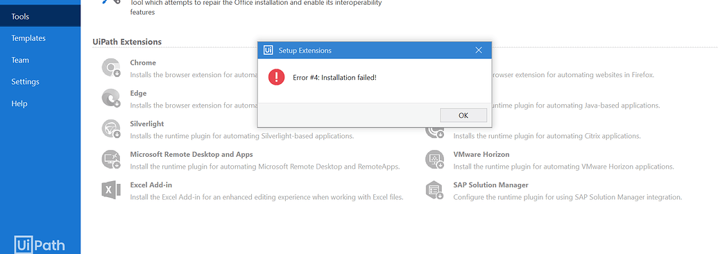

i tried installing extension from studio as mentioned in the troubleshooting @Palaniyappan …i am getting the error…i closed all browser activities as well…still getting the error
Hi @Sirisha_Siri ,
Try uninstall and install the chrome browser again.
