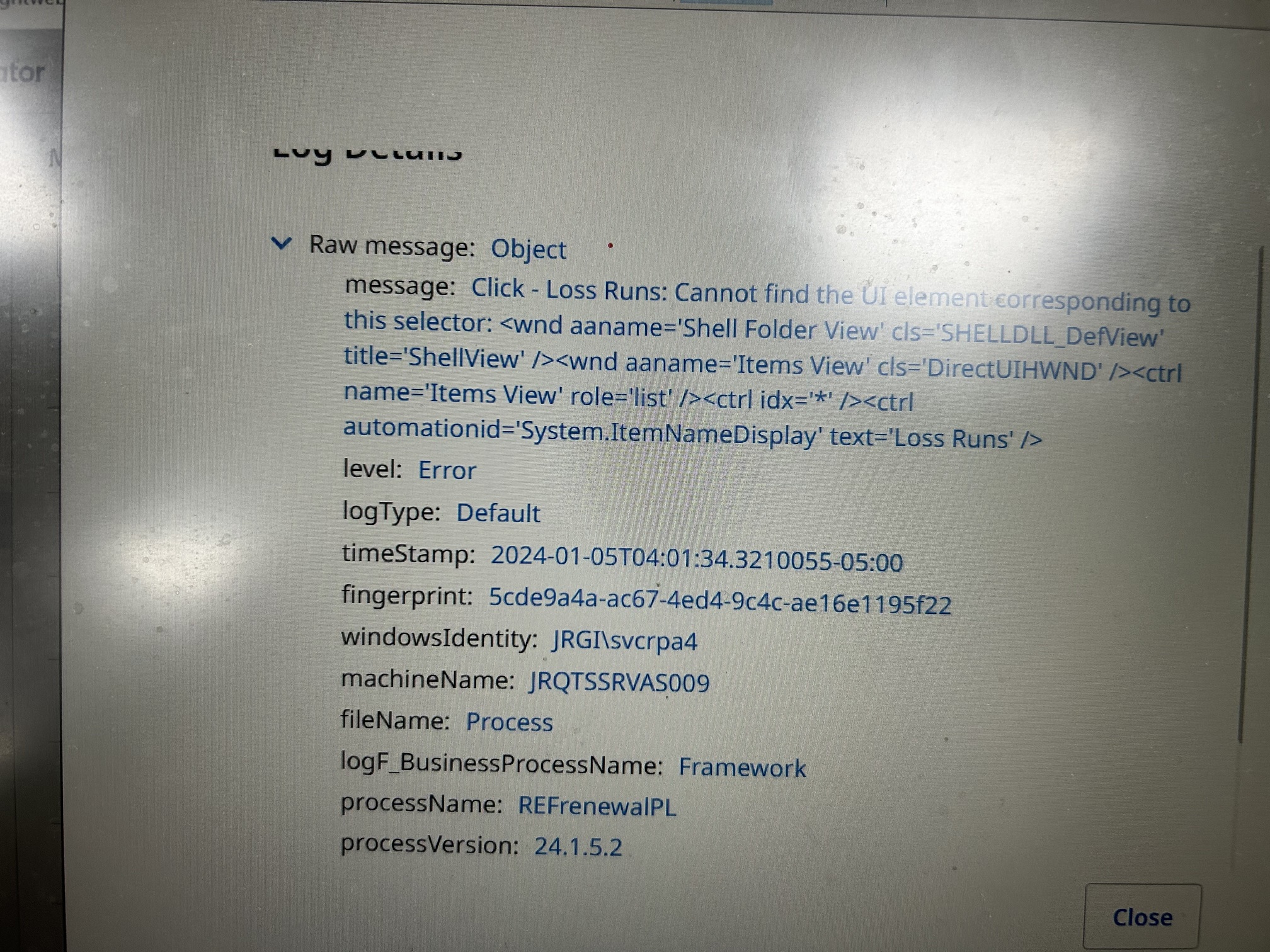

@mkankatala we are getting selector issue please find the below
It was also saying the same there is a selector, in the windows updates the selectors for some of Ui element will change.
For that you have to re indicate the Ui element then it will work well.
Hope you understand!! @Aswini
