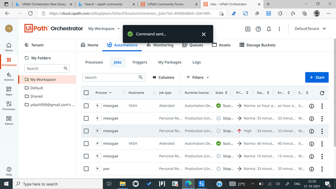

when i run a process from job, it showed ‘command sent’ but bot did not run. It remained pending. what could be the problem?

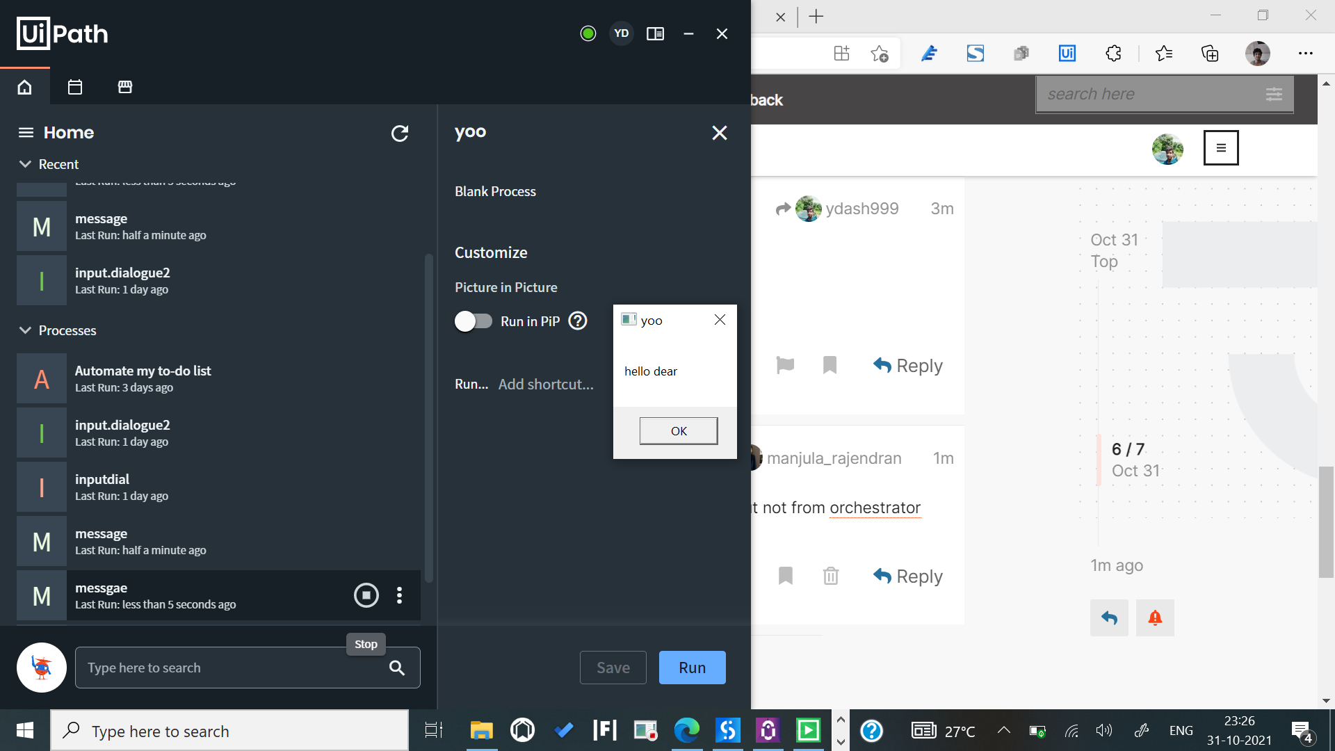

means it shows to download the process ,so i download it and i could run in uipath assistant,but not from orchestrator

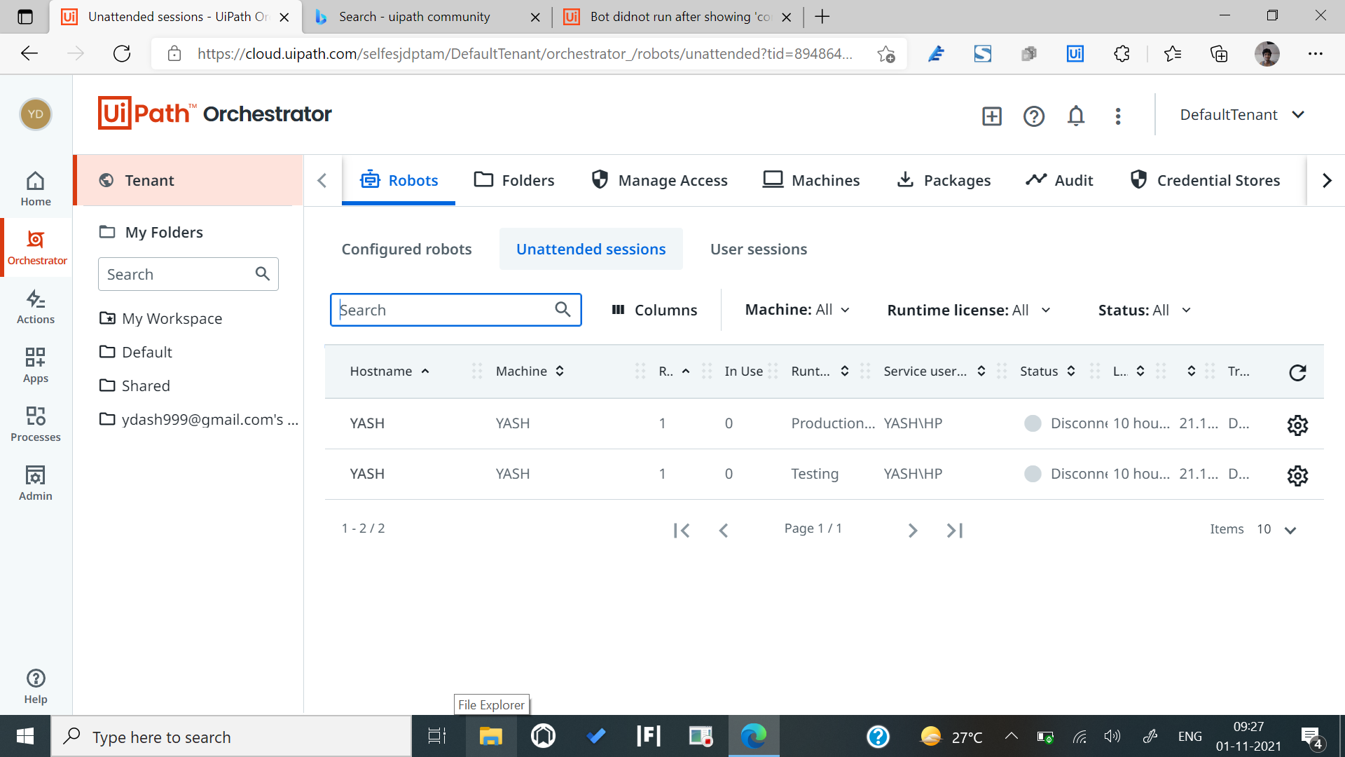

Hi @ydash999 ,
In order to run a job from the orchestrator, your bot must be Unattended. For this, you need to assign User and Machine to the folder where your process was created.

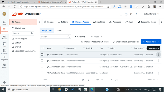

Please confirm the below points,
First, in the Manage Access tab, assign Unattended robot to the user.
Then in the Folder tab, assign that user and machine to the folder where the process was created.
And make sure that you connected UiPath Assistant and the Orchestrator using the machine key which you created in the Orchestrator.
Please follow the below steps…
Tenant-> Manage Access-> More Actions(3 dots)->Edit->Robot Setup->Enable Unattended Robot ->Check Run foreground Automations box-> Give inputs-> Update.
