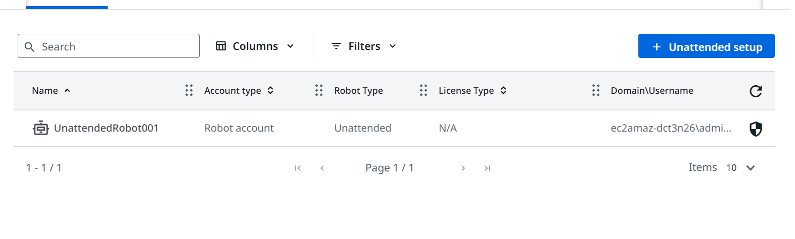

I have installed 2023.10.4 Orchestrator. I had created robot and machine. But when I got to Assistant and try to connect with the Orchestrator It shows
Connected but unable to retrieve a license. I checked the License the show that the license is consumed. In earlier version i have created machines and robot account.

Reason which it explained is " There is no robot configured for the user that attempted to connect to Orchestrator."
You need to sign out from Assistant. The robot accounts don’t have an UI Profile, that means you are using a different robot user from orchestrator (local or Directory).

Click on the Sign out buton
Go to Orchestrator → Tenant → Machines → Create a new machine template → provide a Testing or Unattended runtime → get the Client ID and Client Secret
Assign the Machine template to an Orchestrator modern folder
Go to UiPath Assistant → Preferences → Orchestrator Settings → disconnect the robot → Change the connection to Client ID → provide the Orchestrator URL, Client ID and Client Secret → Connect
If you still have the same error, open Task Manager and observe if the UiPath Assistant is opened with the same robot username as you set in Orchestrator
If not, close any UiPath Assistant processes and UiPath User Service
Reopen the UiPath Assistant as the robot user and check again

Are you able to review your domain/username that you are using to login?
Is that the same username that you have configured as robot account?
