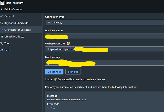

Hi All,
I am facing Connection issue with the Test license. My orchestrator is connected but the robot is unable to retrieve the test license.
Tried-
  1. Checked the license allocation.
  2. Test Tenant Folder > Machine > Allocated user
  3. In test tenant > ROBOT > Provided roles (Allowed user automation, Folder Admin, ROBOT Mixed)
Kindly let me know if I am missing anything.
BR,
NK

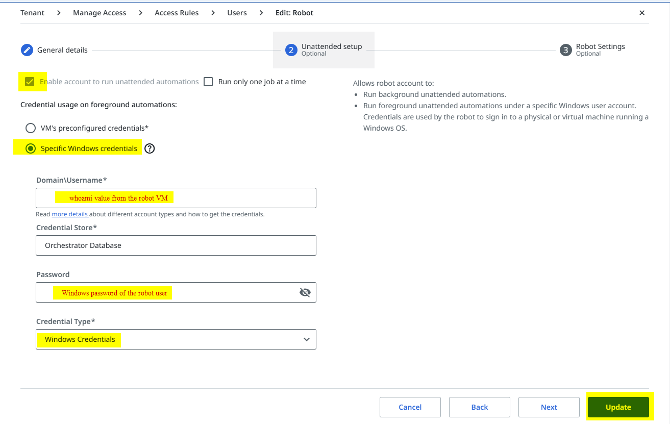

  • In UiPath Assistant → Preferences → Orchestrator Settings → Sign out and Disconnect
  • In Task Manager close any UiPath Assistant processes and UiPath User Service
    Open cmd.exe in the robot session → run whoami → get the value → provide it in the Orchestrator → Tenant → Manage Access → Edit the robot user/account → Unattended setup → Domain\Username
Check if you have this setup
  • In UiPath Assistant → Preferences → Orchestrator Settings → change the Connection type to Client ID → provide the Orchestrator URL → Client ID and Client Secret of the machine template that has the Testing runtime
  • Connect
Let us know the results.
Hi @marian.platonov ,
Thanks for the response but I tried all the above steps but still encountering the same issue.

Thanks a ton @marian.platonov for coming up in call with me and solving this.
Resolution-
Signed out from UiPath Assistant → Changed the Connection type to Client ID → Provided the Orchestrator URL → Client ID & Client Secret of the machine template that has the Testing runtime
(Didn’t signed In to UiPath Assistant)
