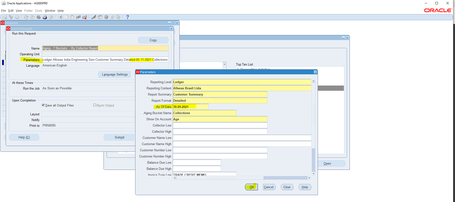

Why As of date is not indicated as required once I click on OK?
Hi, I’ve got a problem at the end of my automation.
I try to run a request in my Oracle ERP and once I fill in everything under parameters and click on “OK” my parameters is not the one that I choose (see below)
Do you know how to proceed?

No the problem is with the bot. When I do it manually under Oracle everything works as expected.
What I try to do is
  • Run a specific request in Oracle
  • Before to run the request fill in some information using type into activity
  • click on “ok” using either click activity or send hotkey activity
but once I use the click activity or use the send hotkey activity, then I dont get the correct info under parameters field
I expect to have this in the parameter field
and actually when I click on “OK”, I get the below information noted in the Parameter field
I solve the issue using a workaround. I’ve click on ok - submit to generate the first predefined parameters (so fake run request I would say) and then do the submit successfully for the other entities and it works.
