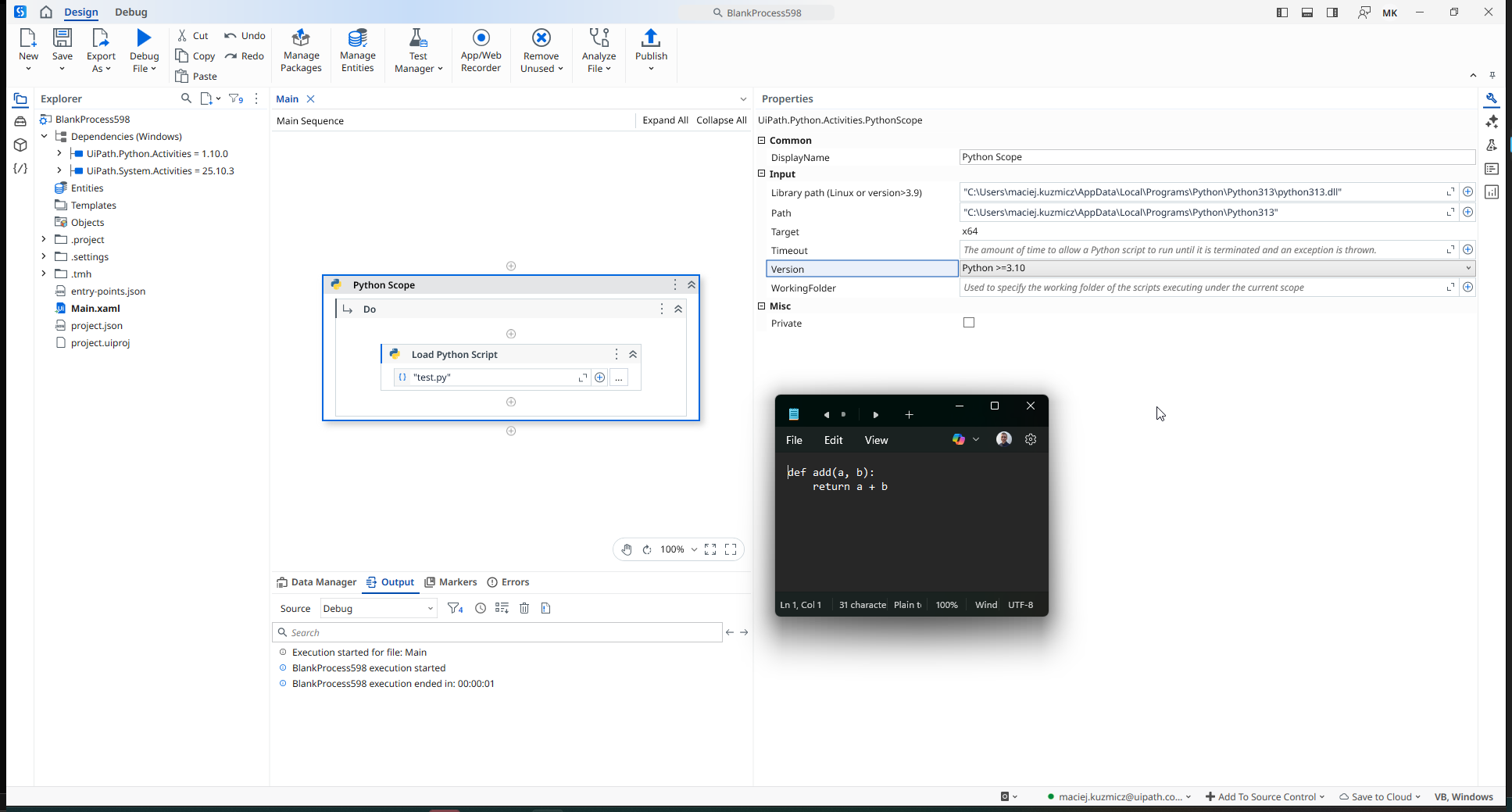

Thank you again for the detailed guidance! I followed your suggestions and wanted to report back with results and a remaining issue.
I’ve attached a screenshot of my current Python Scope configuration for reference. This was before upgrading UiPath so showing an error.

In Python Scope, I initially (incorrectly) set:
Executable: C:\Python313\
Note: I followed below steps for Python 3.12 which is show in the screenshot
After your guidance, I corrected this to:
Executable: C:\Python313\python.exe
The Library Path is set to / auto-resolves as:
C:\Python313\python313.dll
Target is x64, Version is Python >= 3.10.
With these settings, the Python Scope now initializes successfully, so that part of the configuration appears to be correct.

I’ve tried to come as close to your set as I could right now:
The only difference is that I am using the official Python installer rather than the Chocolatey version.
However, I then installed it this way as well, and it worked as well (I tested with Python 3.8 just to cover the previous thing as well):
Could you please share how is your activity configured?
Could you try providing your inputs as new Object(){1,2} instead of {1,2}?
I am also a bit confused why your Python activity doesn’t have an icon. Might be nothing, but maybe it will be a hint as well. It is for sure Python 1.10.0 on your screenshot?
