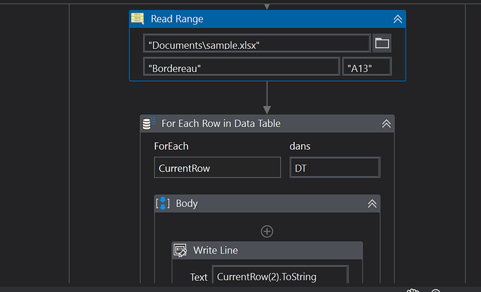

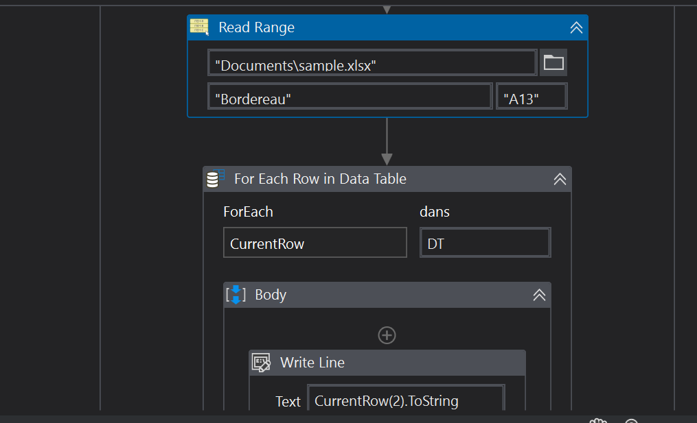

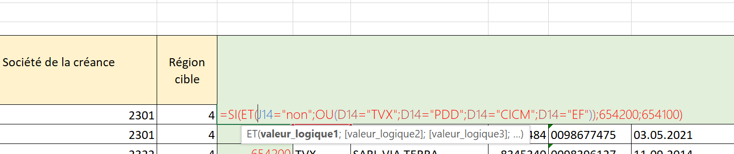

I’m looping throught an “xlsx”, and there is a column in this xlsx that include formula.
I’m using workbook read range to put the xlsx into a datatable.
When i write the value of Column(2) it gives always the same number, whearas they differt in the xlsx.
I dont know why.

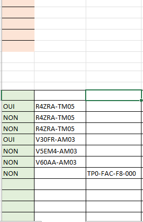

check your input, you have all the blanks above and after some rows you have the TP0-FAC-F8-000
The index starts with 0 so that third column is the 2nd column
So what’s the issue?

no it is not the problem, here is the result when i loop throught the column(2), i know that index begin with 0
Try a output datatable activity, and debug the text dump of your datatable. (Or monitor it in the debug windos icw breakpoints.
Your loop is solid, so it should be the content.

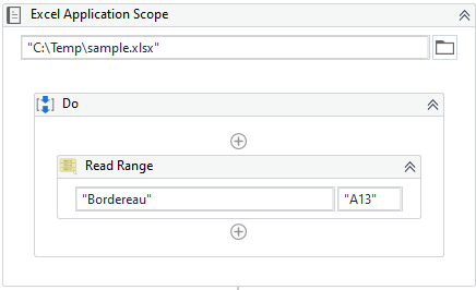

Use a different excel method to read the range:
Use the application one over the system one. This properly evaluates the formulae in the sheet and display the calculated values correctly.
