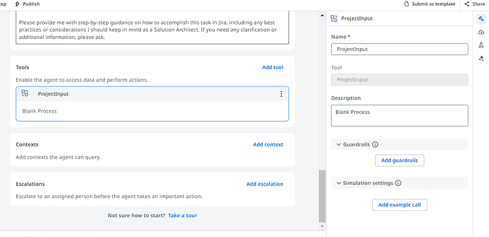

Hello,
i have one UiPath process which contains 10 output arguments.and i am attaching that process to an UiPath aget as a tool ,but atfer attaching in property panel of the tool there no any argument is there which i have in my studio or no any auto generated argument /variable is there.
check below ss
how can i pass arguments which are present in my studio to agent variables?
is i have missed something?
help me on same

When you use the tool then there will be two options of the same process to select, so you should select the process that you’ve published in the folder not the tenant one like this.
here I have one process in Maestro Projects/Agent_Calci folder but it is also showing in my workspace/Agent Calculator so my actual process is in Maestro Projects/Agent_Calci folder.
ok but if i select the proper on ethen arguments will show in properties panel?
Yes it’ll show but first remove the previous tool and refresh the page.
selecting below as per your suggestion
still not showing
Try republishing the process and upgrade the version and then try to add the tool.
ok i wil try this and let you know
