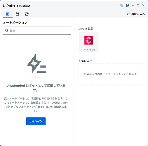

'License not available' message appears on UnAttended machine
I updated the UnAttended machine running UiPath Assistant version 24.10.14 to 25.10.11.
After entering the machine key and signing in on 25.10.11, I see a message saying “No License” and cannot use the Assistant.
Despite this issue, I am able to run processes from Orchestrator, which is quite confusing.
I tried uninstalling and reinstalling it once, but I ended up with the same screen.

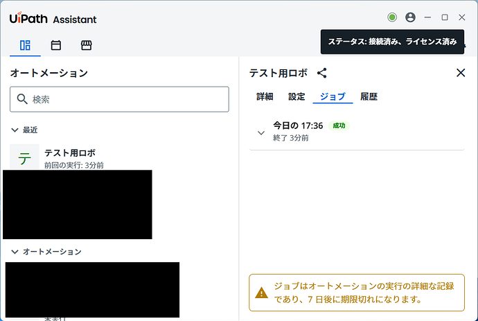

The signal in the top right corner of the Assistant screen appears to be green, so it seems normal, but what message do you get when you hover the mouse over it?

The signal in the upper right shows “Status: Connected, Licensed.”

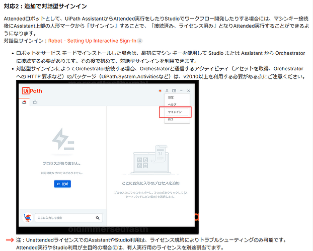

If the user signing in interactively has licenses such as Attended, the process will be displayed, but otherwise, it will not be shown. (If you enable the troubleshooting session, the process will be displayed even when not signed in interactively.)
It seems that starting with version 2025.10, the product specifications have become more rigorously applied to license agreements.

Given the above situation, if the user signing in does not have a valid Attended user license, it may be difficult to execute from Assistant. For a more accurate answer, it might be better to check with official support.
As a workaround, it seems that executing from the command line could work, so there might be an option to substitute that.

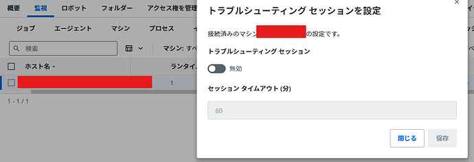

After signing out from the settings on the screen above, I saw “To check the automation here, enable the troubleshooting session in OC,” so I actually tried it.
After enabling “Set up troubleshooting sessions” in OC’s tenant > Monitoring > Unattended Sessions, a list of processes was displayed in the Assistant, and I was able to execute them as well.
After enabling this, I was able to restore the display on the Assistant as shown below.
