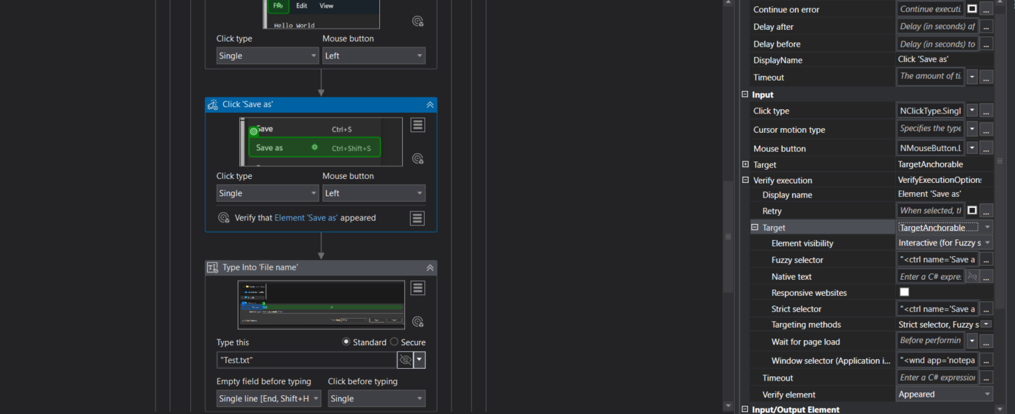

Can you try to set verification target as save dialog in the following click activity?

Tried setting the Verify execution Target to the Save as button and it still didn’t change anything.

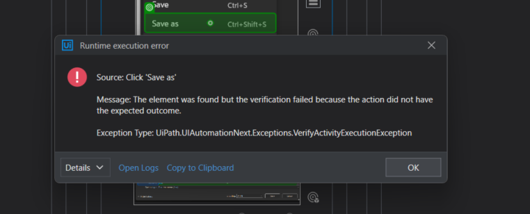

Which error do you have? Can you share error message in both case with VerifiyExecution and without VerifyExecution?
With VerifyExecution
Without VerifyExecution

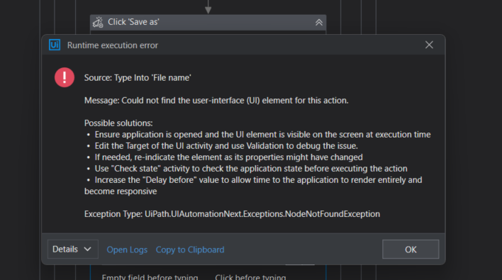

They’re both waiting for this node to start called “Type into ‘File name’”
which it can’t because run since it’s waiting for the Sava as popup to appear to then proceed
if I manually press save as, it continues fine without error, it’s just pressing save as.

Which element did you choose in VerifyExecution? It should be same element in the next TypeInto Activity. (Because it checks if next element appears or not)
This is the error with the same element as the Type into node

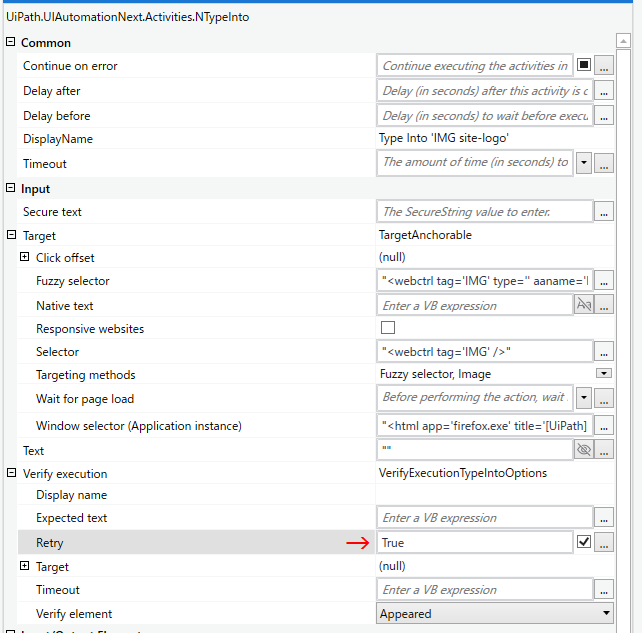

For now, can you try to turn on Retry property as the following?
And if still failed, can you share it’s behavior : Does SaveAs menu appears? Does Mouse cursor move into SaveAs menu? etc.
Still failed, behaviour hasn’t changed.
Notepad opens the File button and the mouse just sits there and doesn’t move from there, and it just waits until the robot fails
