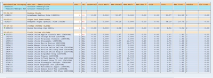

Were you able to update as well the columns that are editable? In my case, I need to loop so I can update the prices or unit of measurement per article

First I need the datatable so I can somehow loop in the SAP Table to update a certain field.

hmmm but this table has many pages.
