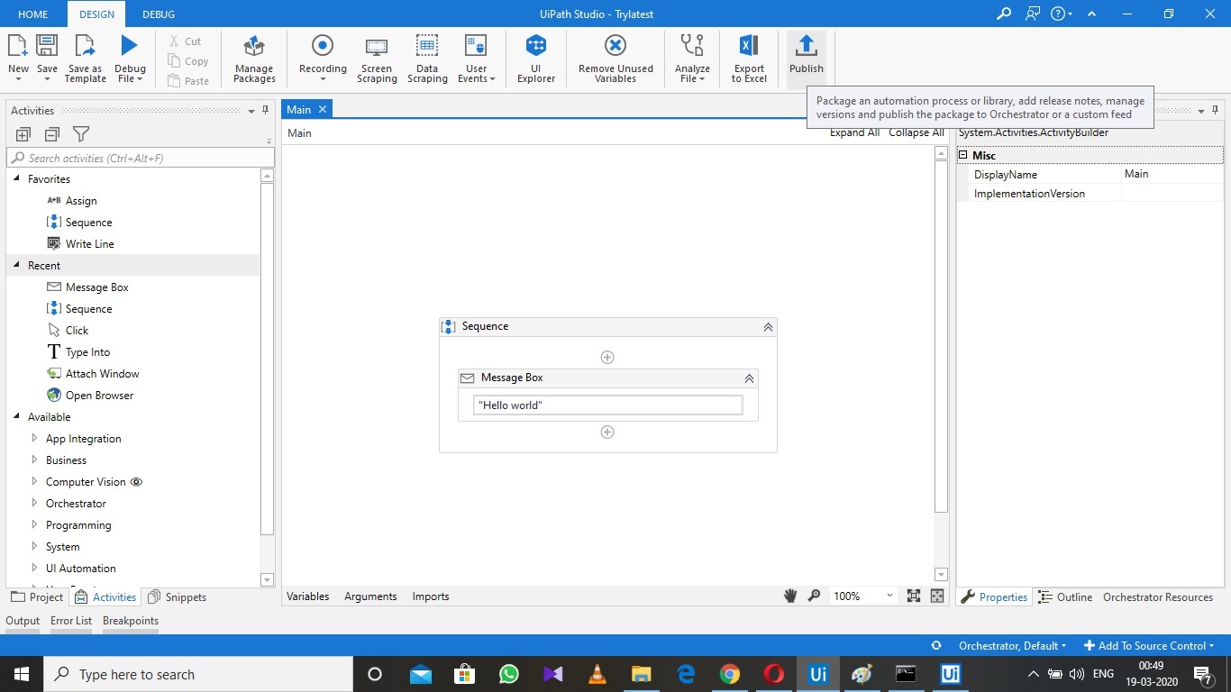

But again I got an issue after finally able to run the job for the Orchestrator , I did not get any stable o/p window console ,it comes and vanishes in seconds without clicking ok and then all it shows green Color with Successfu tag.
My sequence was a Message Box Activity with “Hello world” as input which usually runs good .
